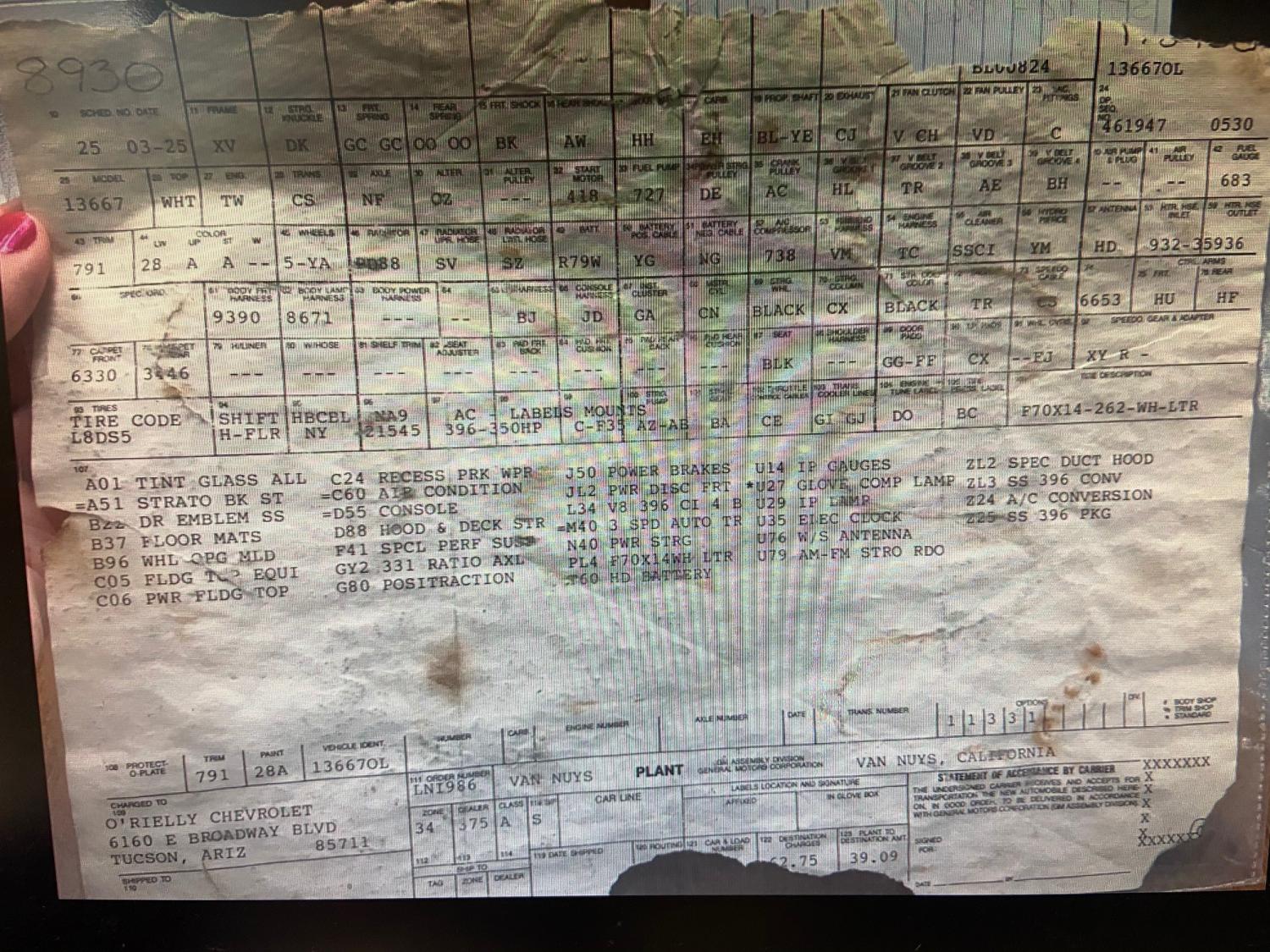

Is this build sheet legit? Font doesnt look right.
136670L178930

I have seen a few build sheets with odd type face on '72 Chevelles, but never on a '70 FWIW.

100% Fake Build Sheet.

Agreed, fake

I doubt the seller even knows it is fake.
Will be interesting to see the pad stamp if he posts it.
I don't get it. Guys are wanting 6 figures for cars like this, but don't have time to remove the alternator (or at least swing it out of the way) for a good pic of the engine pad stamp?

I called about a red 70 Chevelle LS5/M22 last week that was supposedly #'s matching with a build sheet and it looked very similar to this one. It had so many mistakes even I knew it was fake. I emailed them back and told them it was fake and they didn't even reply to me.

Real build sheet posted on another thread, LS5 car for sale. Obvious differences.
