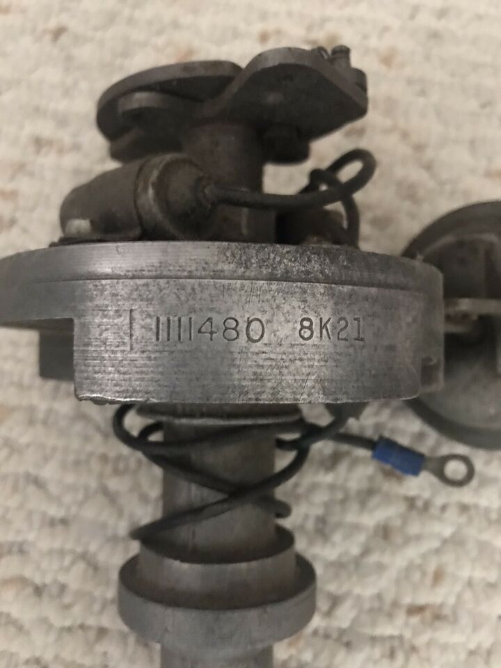

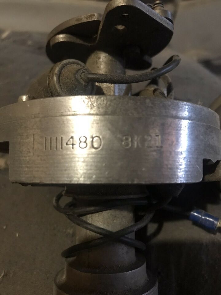

Please see the pics and let me know your thoughts.....
Paul

Looks like it was a 1111481 at one time which is 69 Camaro 307 distributor.
I agree with that. Zero was stamped over the 1.

^ x3

Stevie Wonder could see the one under that zero.

Thanks guys, I just wanted to be 100% sure as I will let the seller know.
So far, this appears to be the second bogus distributor he is trying to sell.
