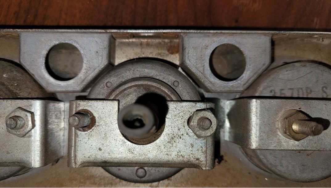

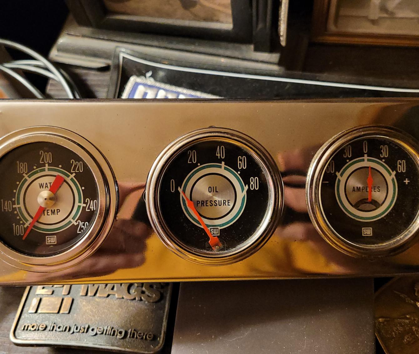

I picked up a triple SW greenline set today from a friend... theyre part numbered from the 71 catalog..but im not sure.
however..the temp gauge appears to be electrical... and the wire is cut short. or am I wrong? do I need to send it to Williamson?

That looks like a hose to me. Hard to tell in the picture, but is there a crimp where it meets the gauge?

That is a mechanical gauge. The capillary tube and line are missing. You are probably better off finding a replacement gauge.

I talked to Mr Williamson... I ordered a replacement. thank you

mine appear to be dated june of 1973. i did not send my temp gauge out for a new capillary tube. i ordered a new version and its close enough for my taste and function. a few days in CLR and the carrier came out darn good for sitting in someones garage for 40 something years

The new gauge looks nice...you would not been able to fix the old gauge. Once the capillary
tube is cut...the gauge is done.

That is not necessarily true. I have seen them repaired with a tube from another gauge.
