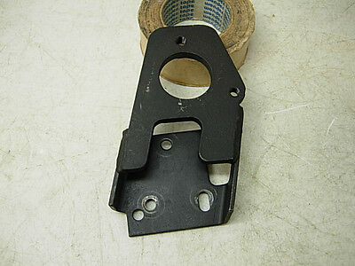

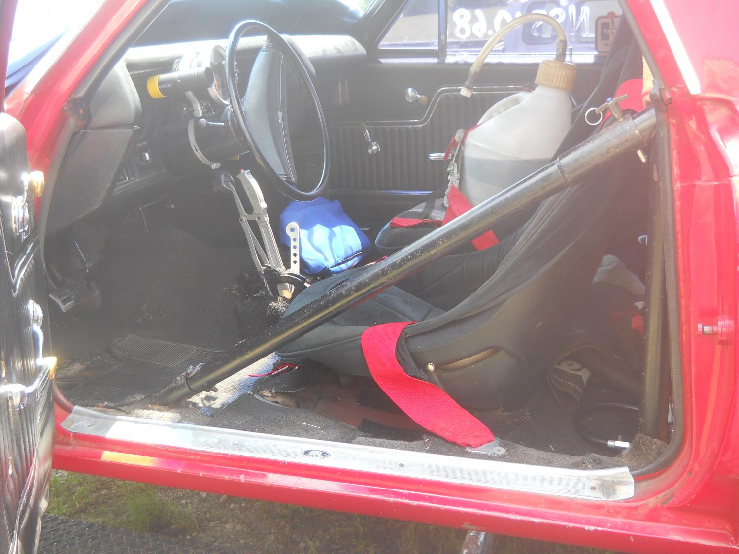

I installed a Super Shifter in the Day 2 Nova a couple of years ago but used the old Hurst H/D shifter rods and what I think was a second-gen Camaro mounting bracket. That kept the shifter body lower down and allowed the use of the early HD rods. When I tried using the suggested Hurst Super Shifter mount, it brought the body up into the car and required me to use the straight arm rods which also meant cutting the sides of the tunnel laterally. I negated that by using the second-gen mount and got lucky in keeping it a bit more clean with a lower mounting position, but those old Hurst rods are very hard to find now.
Does anyone else have a success story in the mounting application that contributed to a good experience? If so I would love to hear about your project and would really like to see some pictures with other Day 2 installations and floor mods? Thanks in advance and here is the modified install that went into my old Nova.Yes...it got a pistol grip handle.
