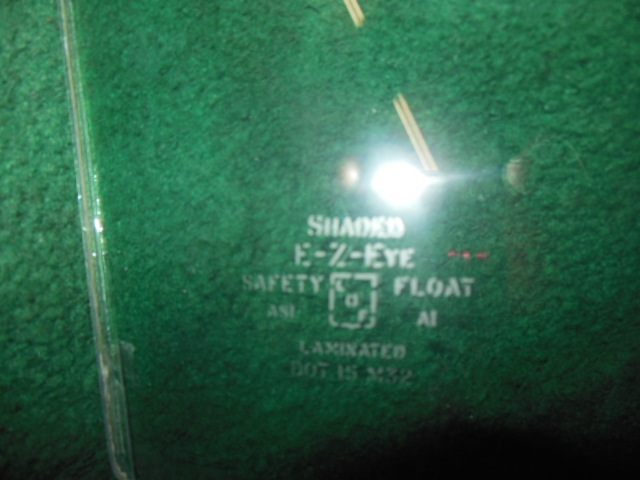

working on a early sept of 69 Camaro looks like the windshield has never been removed & its a shaded e-z eye with a date code of AI can this be possible ??

Look at the date code chart here
AI does not sound right ? LOF correct ?
http://www.camaros.org/glass.shtml

Assuming I'm reading the CRG chart correct:
First letter A = Sept
2nd letter I = 1975
September of 1969 LOF would be AV
August of 1969 LOF would be TV
I'm assuming that the LOF dates are calendar year, not model year? If your car was built in 1968 calendar year:
September of 1968 would be AX
August of 1968 would be TX

I will try to post a picture tomorrow

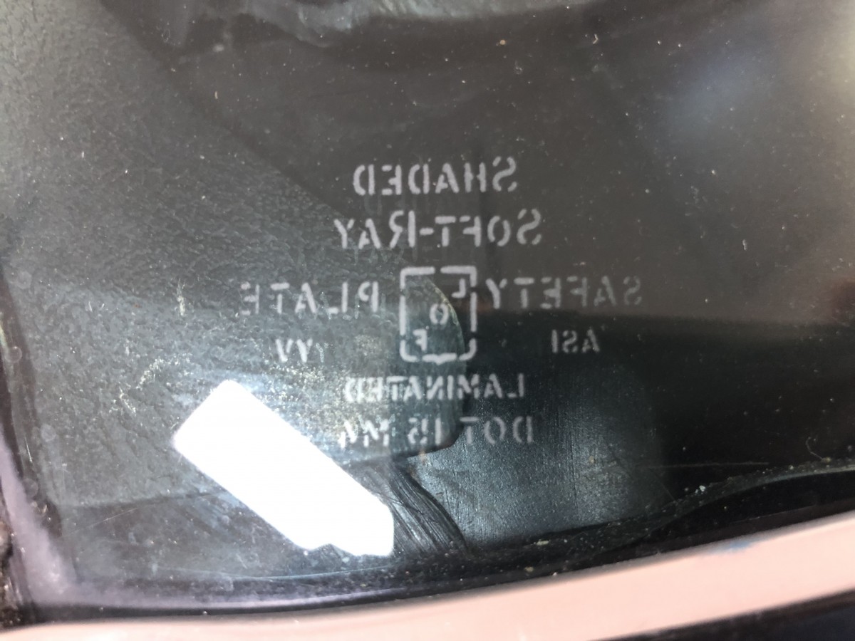

This is original glass from my Aug 69 SS for comparison.

Default glass
here is the glass in the car the tint on the top is more of a blue and not green

Here's a factory windshield...Joe

E Z Eye = not original.
"Supplier and non-GM OEM Tradenames
Glass supplier tradenames, like "Duplate," "Solex," "E-Z-Eye," and "SunShade" do not appear on GM OEM glass. "
