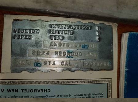

Here's a flip shot of the POP...1'st digit of last six a 3 or 5?
124379L308927 - 124379L508927

it would be nice to see the data plate to see if the POP is even for that car....was that my outloud voice?

You can see the VIN more clearer in the ad pic. Its 124379L508927.
My car is 9L508474 (453 units before) and my NCRS doc says my production date was 11/14/68.
This car was built 11B
This cars POP says sold on 11-23-68.
Engine is from August V0821DZ
Rear is Nov BU1107G
Trans is from September P9P26
POP book looks brand new
some things just dont add up.

I don't have any issues with the POP or the POP dates - I see several cars with months old parts in them in this timeframe. Cleaning out the corners it would seem.
I would like to see the tag.
