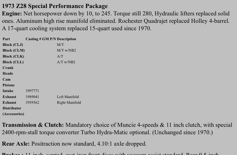

I recently purchased a 1970 LS6 CY Transmisson case with partial vin and GM of Canada Docs. I know the internals are different than standard 400’s. My question is about a 73 Z28 CY Transmisson. Would all of the internals be the same as a 1970 CY Transmisson? Thanks Steve

I’ve been talking to a few people about this and they seem to think the governor, and valve body would be the same for the high shift point. It seems they also still used the 6 lug 2400 high performance torque converter. Any other people have some input?
