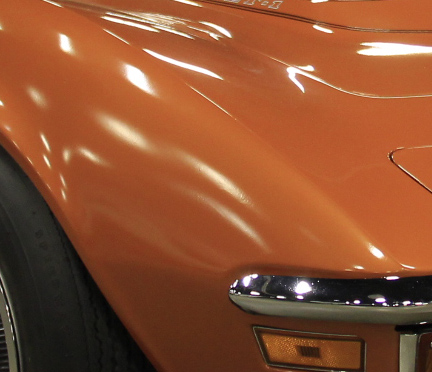

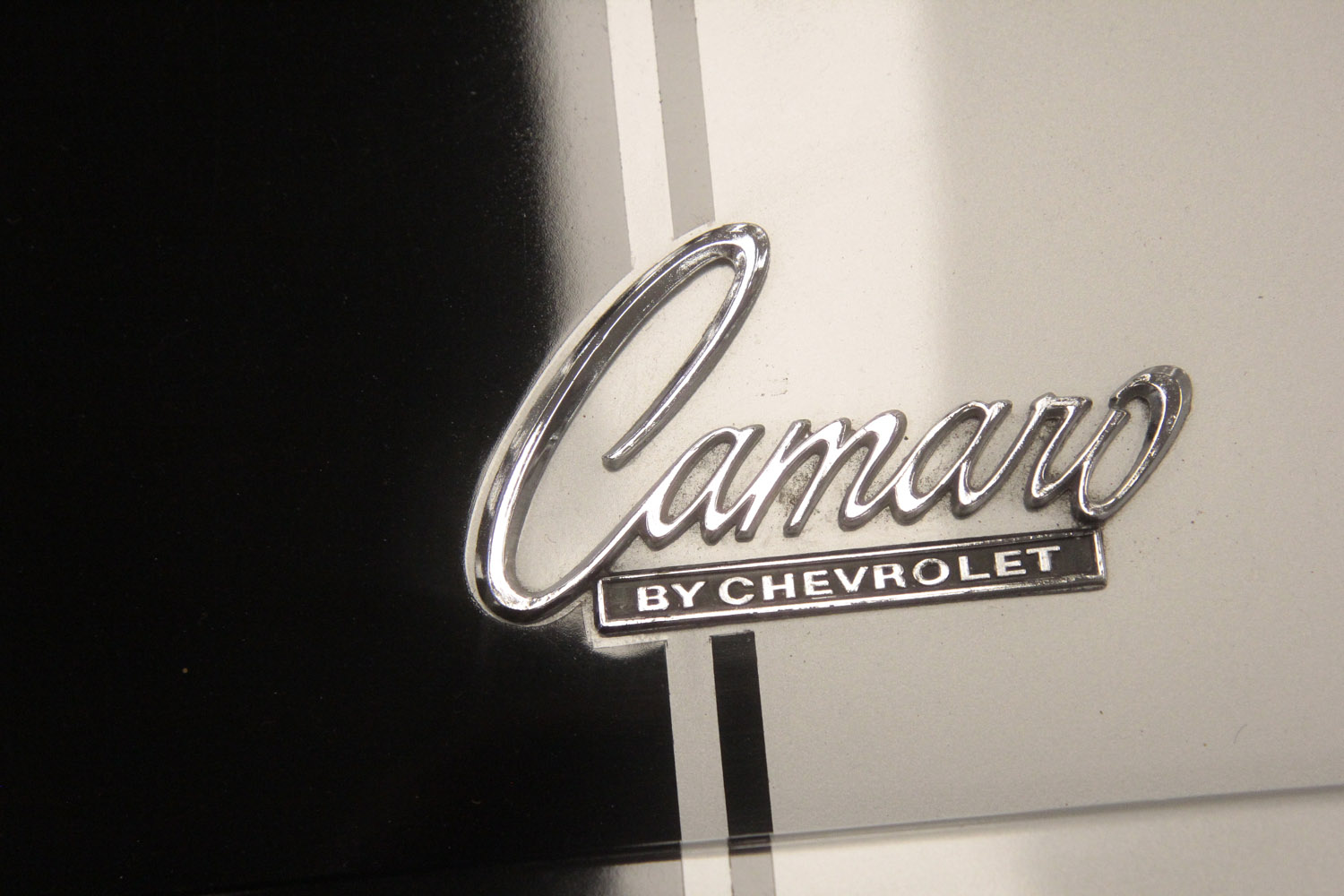

I know there are folks here who have actually worked(or still work) for GM. Out of curiosity, back in the day(and even now) do new cars get wet sanded and buffed at the factory?
I have seen many pictures over the years of cars being painted at the factory but I've never seen a picture of a car being sanded and buffed at the factory.

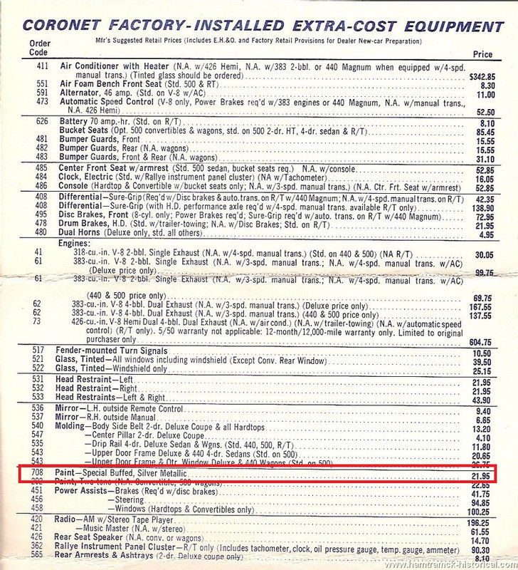

Chrysler charged extra for buffed Silver Metallic on it's cars during the middle to late 1960s. That was the only "standard" color that was buffed and had a cost to it.
