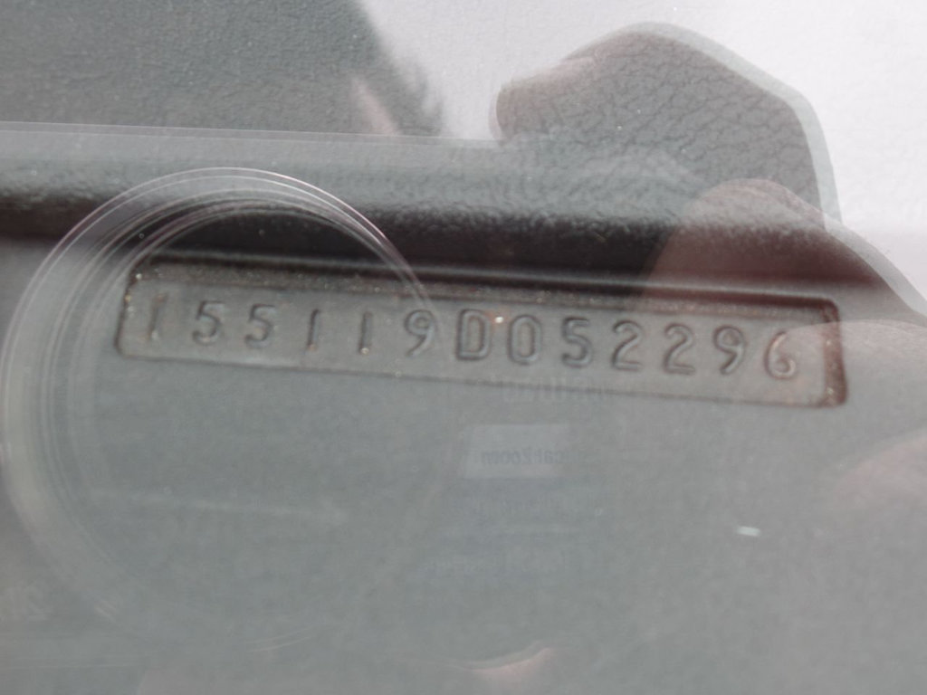

Subject VIN 155119D052296

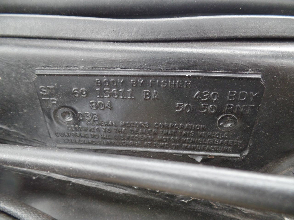

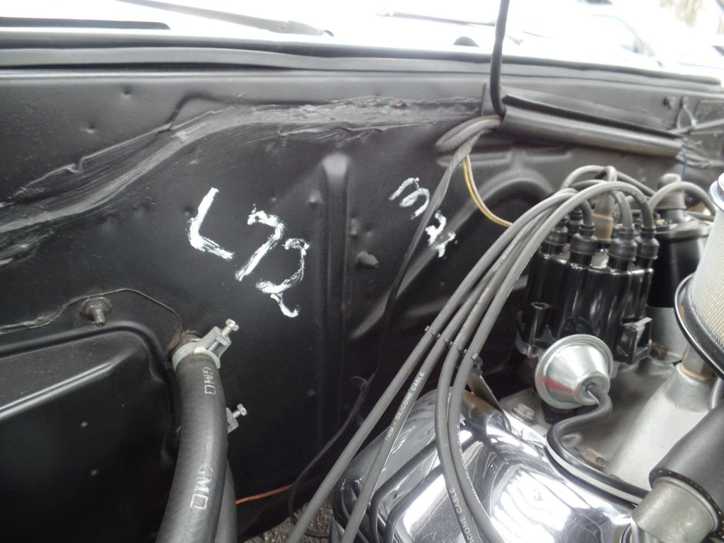

Cool car but 55 Vin indicates BelAir 6-Banger...regardless of firewall shoe polish.
Goofy too is the TT has the 56 for a V8 car, like the Nova tags but in reverse or?

Same car featured in Chevy Rumble mag' 10 yrs. ago also offered @ Mecum 01/17 w/ not a word of being an original 6-Cyl. car.
https://www.mecum.com/lots/FL0117-26...bel-air-sedan/
What's w/ the TT Rick, did some plants produce 6-Cyl. cars w/ '55' in the Vin but '56' V8 designations on TT's or tag not from this car?

That tag looks like a repop to me

Sold for 30K at Mecum. I don't know big cars but 6 cylinder cars usually show a V8 body style on the trim tag regardless of the engine size.

Duh, can't believe I missed the 6-cyl VIN.
