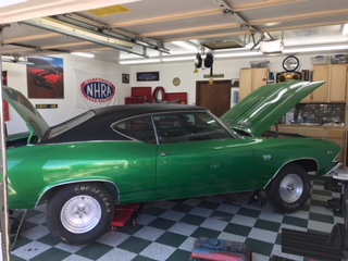

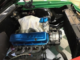

I know this is the Day 2 forum, but I’m shooting for a little later than that. I’m trying to build what someone from say late ‘70s through early ‘80s would have if he was wanting to be the baddest guy on the street. The only caveat is I know a lot of those mods were pretty tacky so I’m trying to avoid those. Right now, what I’ve got are big and little satin Auto Drags, Hurst V-Gate shifter, Moroso valve covers (blue soon to be gold), Lakewood ladder bars and driveshaft loop, Holly blue electric fuel pump with braided line and red and blue fittings and big orange Fram fuel filter. I’m going to make an orange NMW battery box out of a competition engineering box for the trunk. On the rear end I’ve got a Mr Gasket aluminum cover. My questions are this:

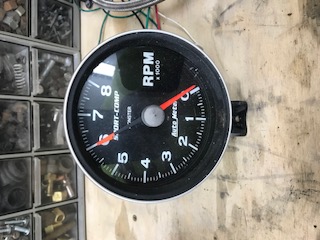

1. Will my plain 5” Autometer monster tach look right in the car? It was one of the first things I bought for it when I was a kid in the mid 90s. Did they have them way back then?

1) yes, Autometer “monster tachs” were the rage during this time

Love that Chevelle. I think you're on the right course with much of what you have listed. I like the sump idea over that of a fuel cell myself (fuel cell was more pro street). Maybe hang a large fuel filter back there too. Ladder bars rock on those cars and that's spot on there. I think you're OK with an older MSD. Perhaps a dual point and good wires to finish things off in the engine bay? Tach...definitely Autometer and you gotta have a shift light too.

I would use a standard auto meter tach with no shift light.

Your Chevelle is very cool build.

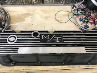

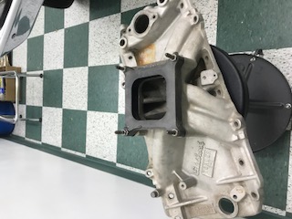

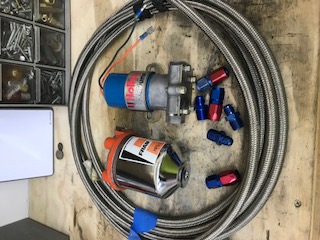

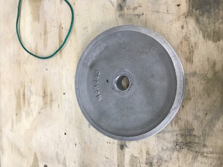

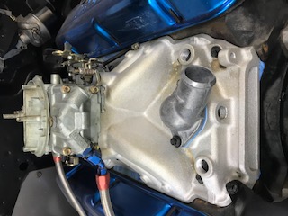

I really didn’t want to cut the trunk floor for a cell so I’m glad to hear a sumped original tank would look appropriate. Do my fuel system components look at least kind of correct? How about my Victor Jr manifold? When were those introduced? I have this old Torker but I put the Vic Jr on before I decided on how to do the car. Is the pulley I have the one Bernhard was referring to? I replaced it with a Z/28 deep groove but it’s an easy swap. I also have the M/T valve covers but the crinkle finish is flaking off. I got the idea for the gold Moroso s from pictures of Lee Shepherds pro stock camaro. The tach in the picture is the first thing I bought for that car years ago.

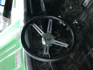

The Corvair turbo mufflers interest me. Were they fairly aggressive sounding? How about my Olds steering wheel? I like it better than the 3 spoke Chevy wheel.

The fuel system looks fine. Pretty much the same thing that I have. I've got 2 of those Moroso pulleys in the shelf that I ran many years ago. I'm using a stock type chrome pulley now, and I haven't had any problems with it at 7000 RPMs. I'm running a Holley Strip Dominator on mine that I bought around 1988. Victor should be fine. The Torker would probably fit better with a early '70s build. The clutch fan should be fine and I would use it over a flex fan. My old flex fan is now on the shelf. They are not much good for cooling. I've got 2 electric fans on mine now, but not exactly period correct.
