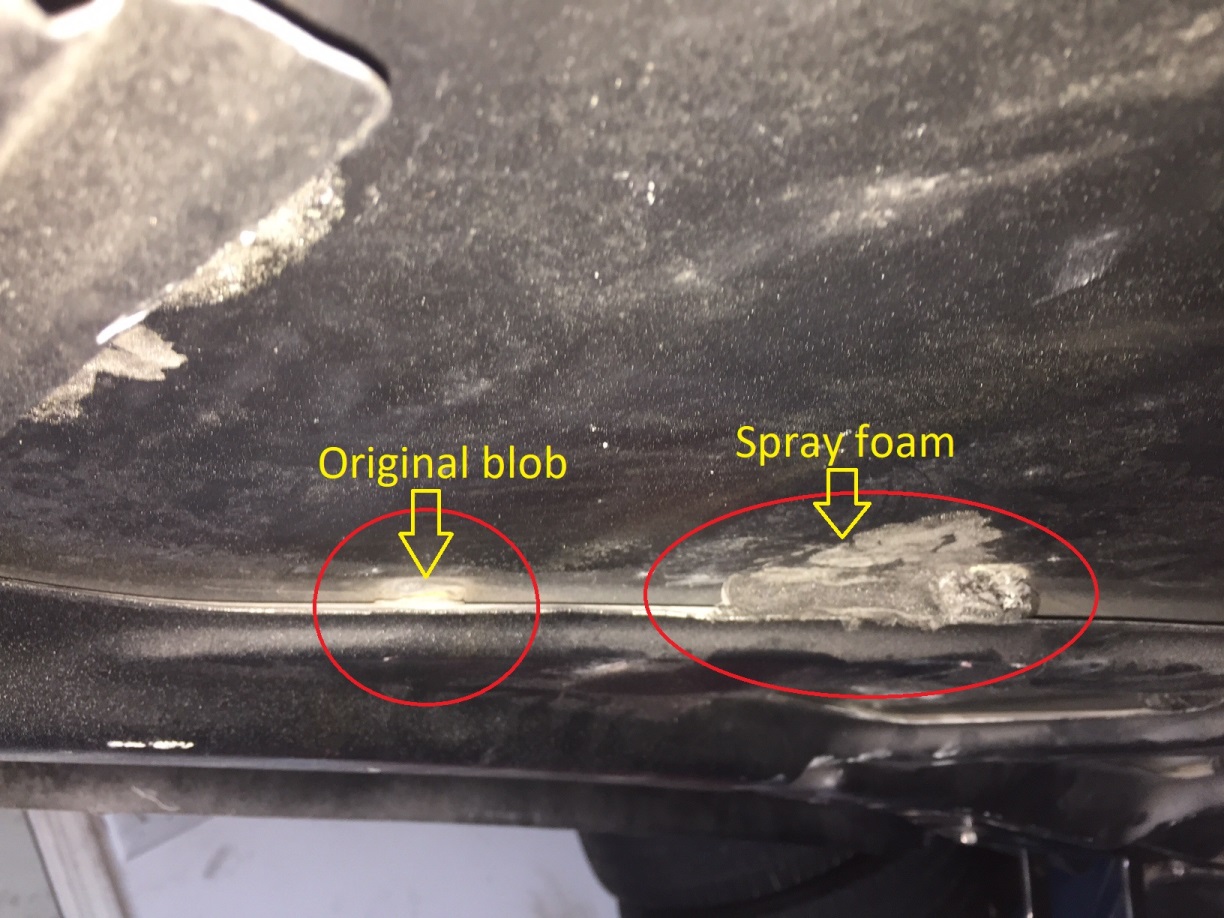

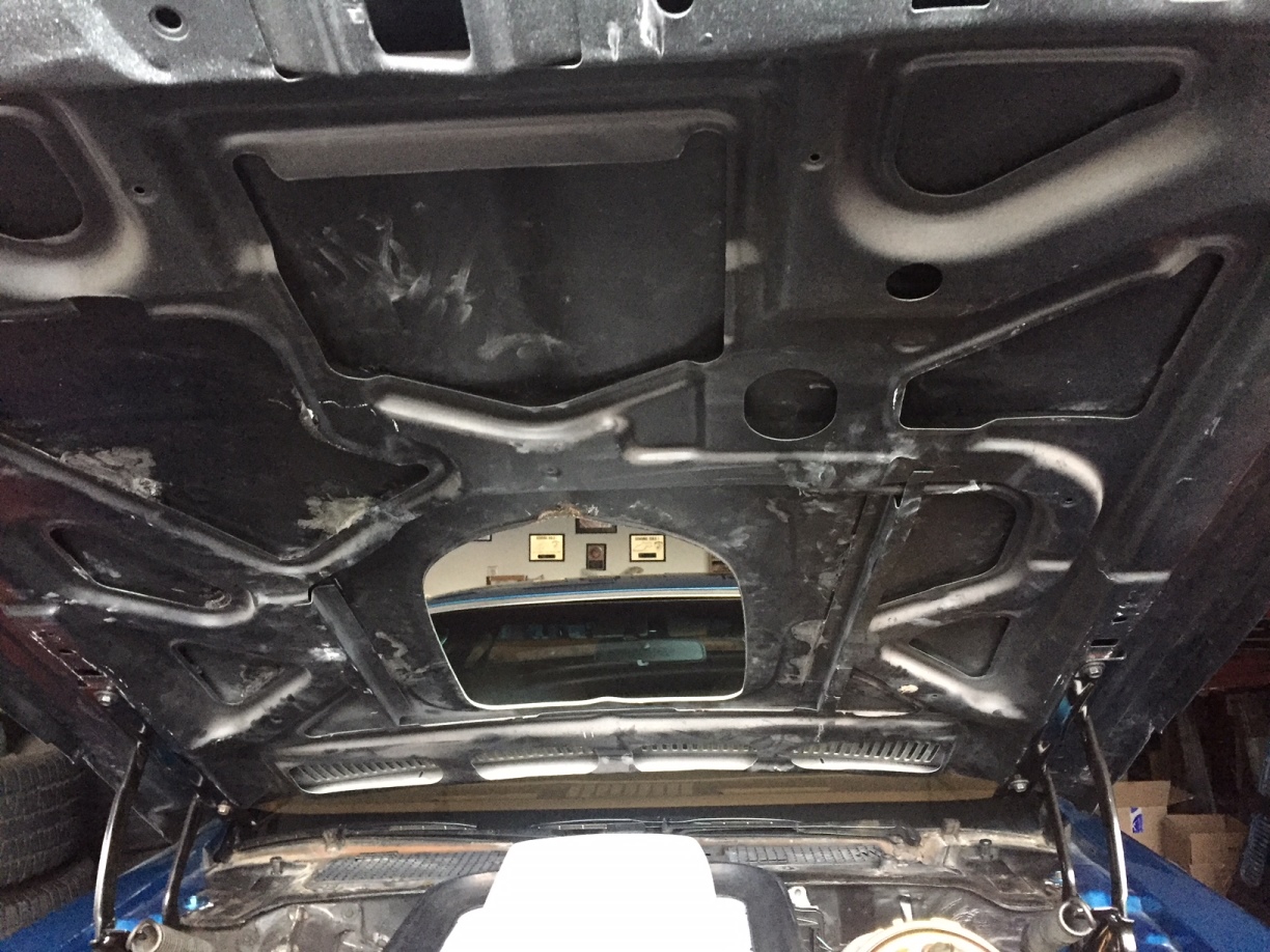

I recently found a really nice Trans Am hood for my '75 Bird. It appears to have been media blasted on the underside. The metal is pristine but the blobs of adhesive that are supposed to support the space between the internal bracing and the outer skin are missing in a lot of spots now. Someone had tried using cheapo, hardware store, spray-foam insulation and that is just useless. I have scraped most of it away.
Anyone have any suggestions on what type of adhesive could be used to inject into the spots again to remake the supporting "blobs" that should be there? It needs to be something that keeps its form while hardening and stays in that one spot.

steve, go to a auto body supply store, they will have this specialized product. It is a liquid expanding dampening foam, same as oem on new cars today.

This stuff? 8463 3M
https://www.3m.com/3M/en_US/company-...3193646&rt=rud
The other formula (8458) they make is a rigid design for door pillars and other internal applications.
https://www.3m.com/3M/en_US/company-...3194025&rt=rud
Added problem is that you have to buy their applicator gun and tips...more money!

I have used seam sealer a few times and it worked well.

----Yup, Mike. The one thing you definetly wouldn't want would be anything that expanded as it cured. Would put a lump on the other side of the hood........Bill S

And seam sealer does not get rock hard. Carry on.

I’ve reskined a few hoods and prefer to use panel bond adhesive. Two part epoxy which does not expand. It is amazing how stiff the hoods turn out compared to the originals which have begun separating.

I thought if the panels were bonded tight the skin would not float with temp change which may cause it to show flex/wave at the adhesion points ?
