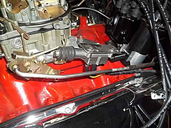

----All the years I have messed with these old cars I have never had a 67 Chevelle SS 325 horse/T-400 car. Can someone with more knowledge than me tell me where the kick-down switch is located? Maybe, if I'm lucky, a pic of same?.......Bill S

Sorry, no pix handy, but the kick down switch mounts to the driver's side rear of the carb and is depressed by the primary throttle shaft "bracket", with a small contact tab attached IIRC.

I believe its the same as an L-35 Camaro. Mounted on the rear carb stud.

Yes! That's what I was trying to describe, thanks for posting!

----Thanks,,,I have the switch, but now I see that I am missing the tab on the carb. Eric just finished the job, and of course, its beautiful. Ill call him and see if he has a tab laying around. If not does anyone else have one?.......Bill S
