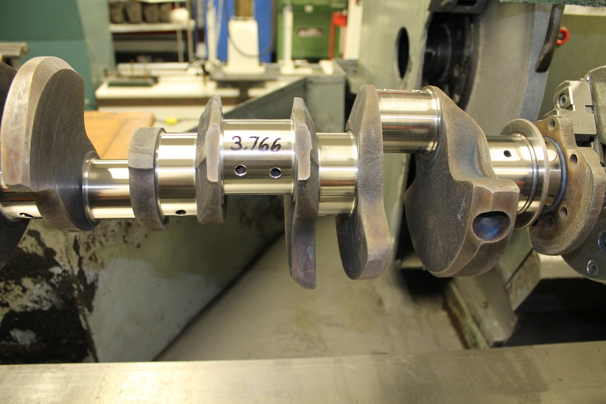

So I tore the engine down and there was some rust, but no other problems were found. After cleaning the crank which showed very little wear but was under the low side of the spec, very strange, so I decided to ck the stroke and found it to be .006 under the factory stroke on one throw, so at this point I figured we should grind the crank to get in the middle of the spec and set the stroke and index, which will help seeing the block cannot be decked. Stroke was set on every throw at 3.766 exact along with the index corrected.

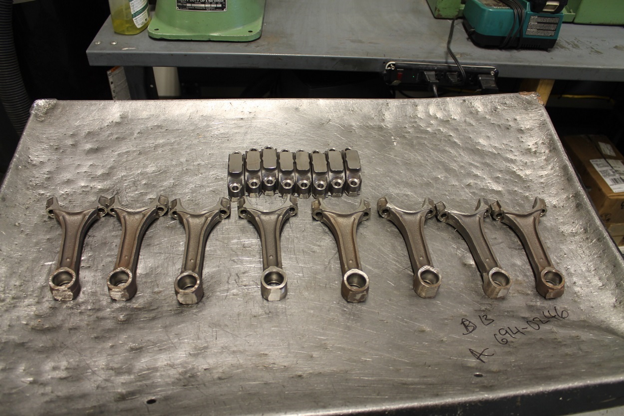

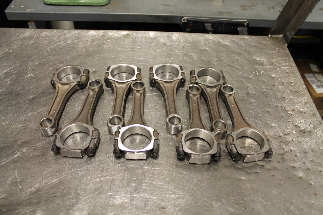

Connecting rods were wet magged, length set, small ends checked for press, then finally resized, then balanced.
