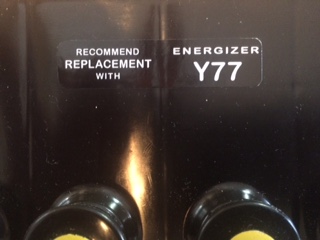

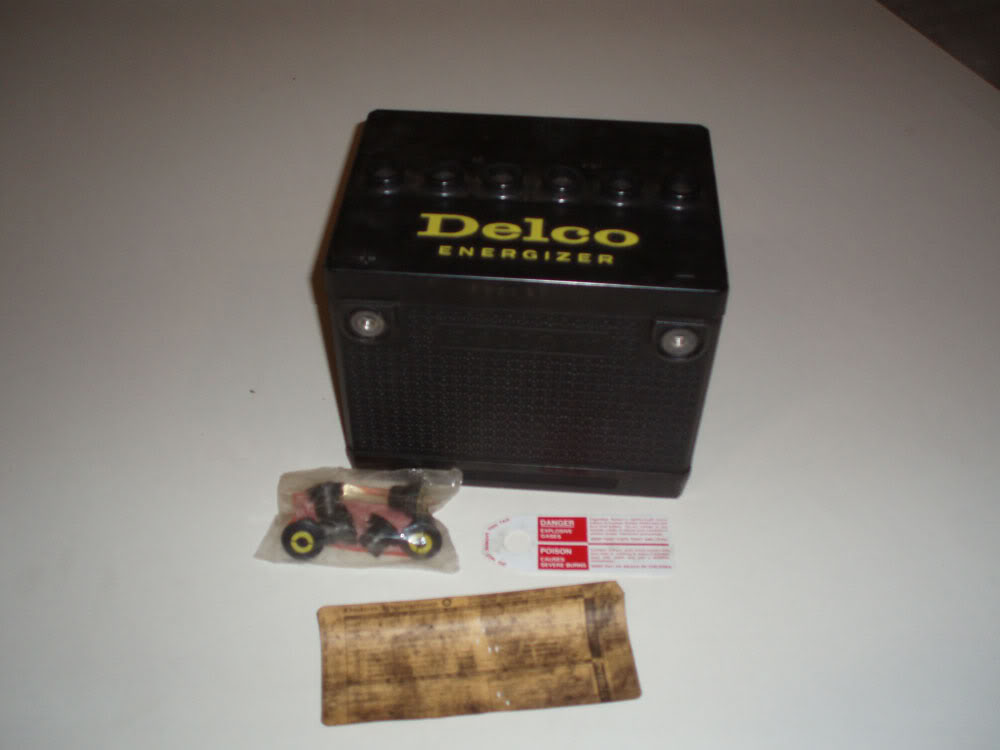

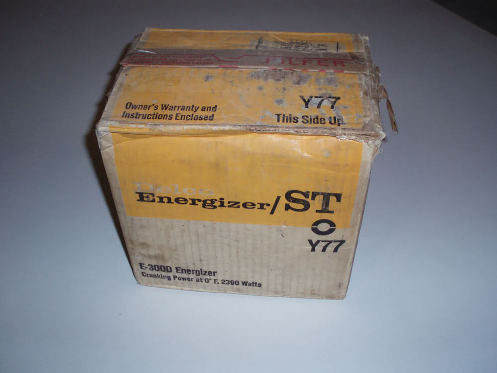

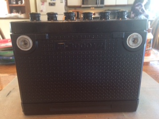

What battery is acceptable to use for a correct replacement for my late build 69Z
I don't see the exact replacement in some of the repo companies.
Car is a 09E of 69 build, X77 car.
Appreciate the advise - need to get one on order!

To the best of my knowledge, nobody reproduces a correct battery for any 69 Z28. Your car should have had a Y77 sidepost battery.
The only sidepost repro is a R89 which is not indexed correctly .
Same problem for early cars that would have a Y55 top post battery. Maybe someone knows something different but from what I know 69 Z owners are out of luck in the repro battery market.

Eddie. my burnshed brown x77 Z my date is very close too yours i used the R89 side post, judged no deduction in points in 2006

My plan for a 302 Car is to "WHY" Yellow it out, the Z28 using the Y55 & Y77 are the the "normal" Yellow E-3000 series ( Amp hour rating of : 45 Ahr)
So a compromise would be to Yellow out the restoration battery by using Yellow painted delco eye caps & The color was used on the caps and to highlight some of the text on the battery; to give it the appearance of the reverse post batteries which are currently not available.
I saw someone post a Y77 conversion of the current side post offering in a effort to look the part. Nothing you can do about the positioning of the posts in relation to the fenders etc.
Might be a good option.
