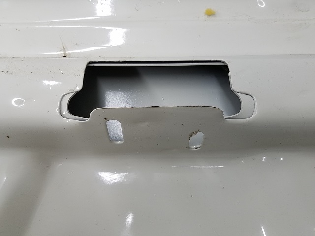

How do I ID the below deck lid as being GM or aftermarket repro ???
Could not find date code as shown in another current deck lid thread

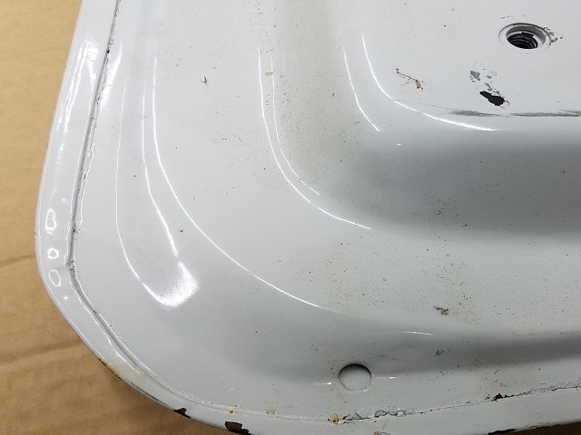

I'm still wanting to determine what I have with my first gen Camaro deck lid ???
Cant see date anywhere
Doesnt have any "hole" like the service replacement.....
Seems like a new/never installed but I cant prove anything !!!!!!

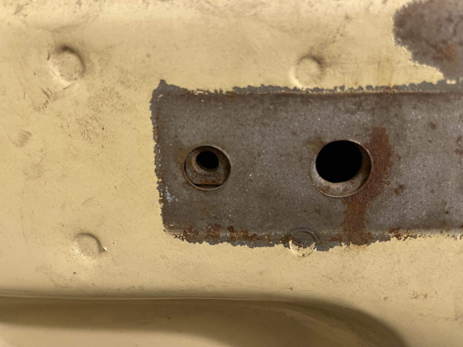

Has no stamped numbers/letters that I can see

Date stamped will be in the area of the link posted previously. More than likely filled from heavy paint. But to narrow it down that lid was used between Jan-Feb to around April-May. Reasoning is it appears to have the TA holes as well as the tabs at the lip of the lid.

Do the repros have the TA holes ?

Yes but I have not seen a repo that has the tabs also. Not saying there isn’t any but I have not seen them.

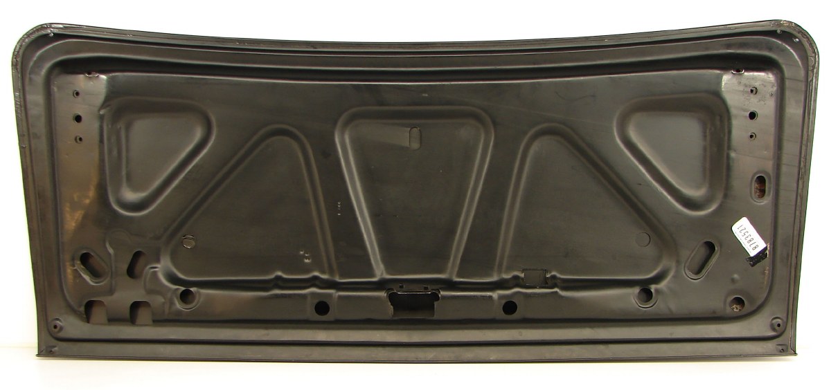

Charley, I realize its been a few weeks but while searching for another topic I ran across this pic in a thread over on CRG. Repo lid without TA holes but without tabs.
http://www.camaros.org/forum/index.php?topic=3752.0
Also compare the stamping contour in the emblem location.
REPO
