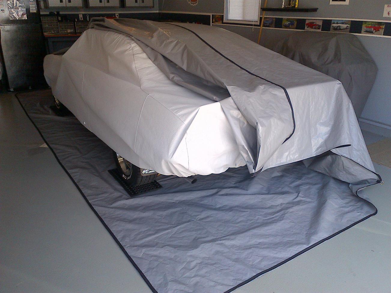

For my cars not in heated storage I've used the Car Jacket product. You place the car in a bag with desiccants which removes moisture. In the spring they look good as new. I've used Stabil product for fuel preservation.

I use the car jackets too. Just make sure you dont have a set of headers warm when you park the car on the bag....

Yes I make sure the bag is flat against the floor so as to not contact have any exhaust touch and melt a hole in bag. Also seal the car on a dry day to minimize initial moisture in the bag.
I started using them when I noticed in the spring that my car was actually sweating due differential temperature (the car being very cold and storage area warmed quickly). Just like an ice cold drink glass in the summer.

Car Jackets are Awesome for non-temperature controlled storage! Even bare metal rotor faces are still shiny and bright... no corrosion.
I also use a jacket in temperature controlled storage as it keeps the dust off of your cover. Cars come out as clean as they go in.
The re-usable canister dessicants also work great.
