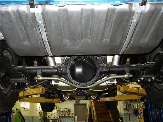

Opinions on authenticity please.

The trim tag has been off the car, rivets not pierced .

Which is the reason I'm asking if it's real?

I don't like any of it..

Subject VIN 124377N237018

Here is a tag to compare. I apologize if this belongs to anyone here.

The tag looks good to me. But I'm not an expert.

I'm no expert which is why I'm asking but I think based on the the other tag Steve posted and the alignment with the vin it's real but has been off the car. The engine looks to be correct but the trans and rear are not original which begs the question why go through the trouble of faking the engine and not the remaining drivetrain?

In order to evaluate the engine stamps, all paint needs to be removed from the pad.

I'd say the tag is a fake. There are differences in the 2 tags for sure.
