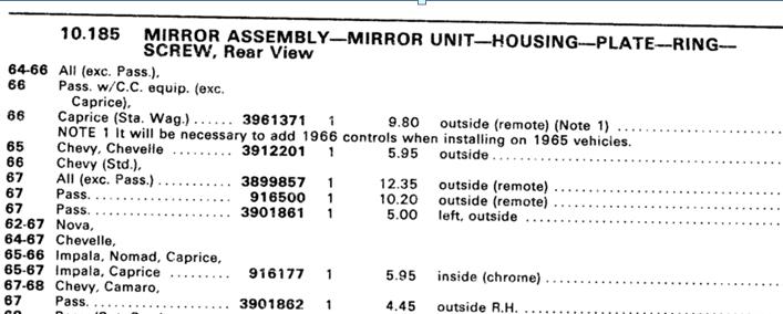

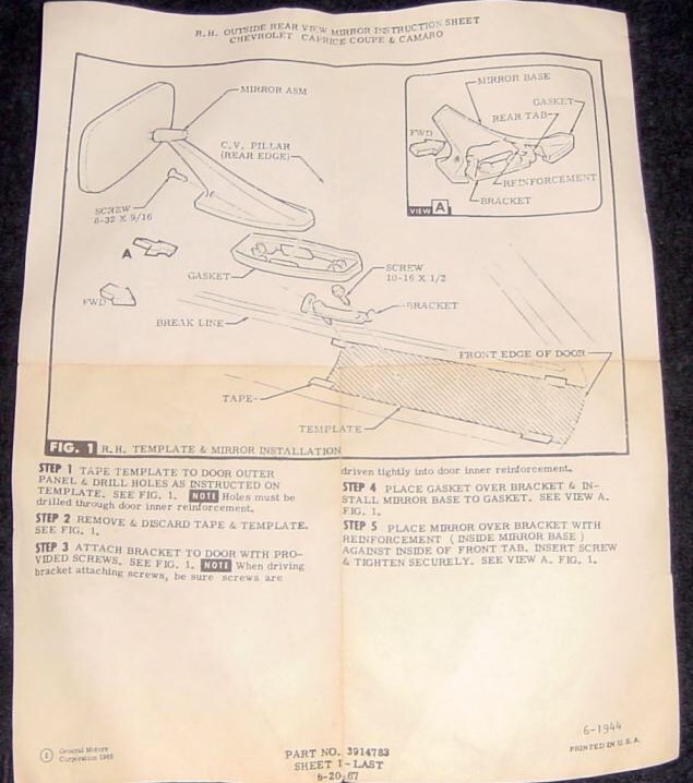

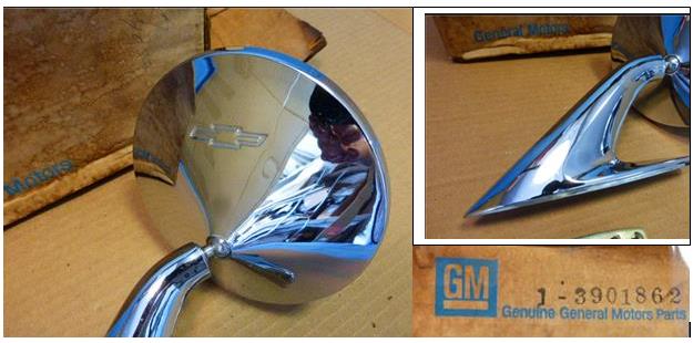

On my 68 I need passenger outside mounting location, I put a new door skin on the passenger side and my old skin was stolen by the metal hounds before I could get the mirror mounting location.
