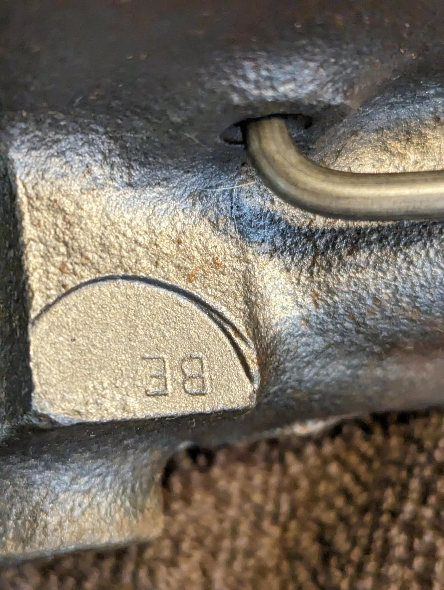

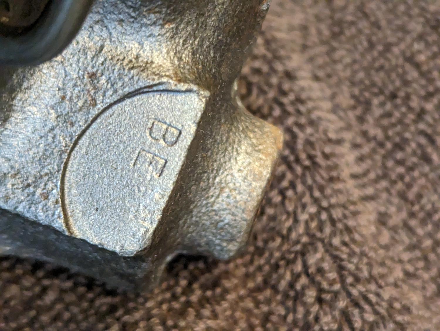

Anyone know what application a BE stamped 409 master cylinder is for?

1971 Chevelle with power disc brakes. Possibly 72 Chevelle as well.

Also used on '71/2 Olds Cutlass and 442 and Buick Skylark and GS. Not sure if used on Pontiacs of those two years.

1972 Chevelle for sure with PDB

Also for 1971 GTO....Was also supposed to be on the 1971 Firebird but many of those i have seen still some with the "EB" from 1970....
Odd...I don't think you were ever supposed to see these MC codes used 2 years in a row..
