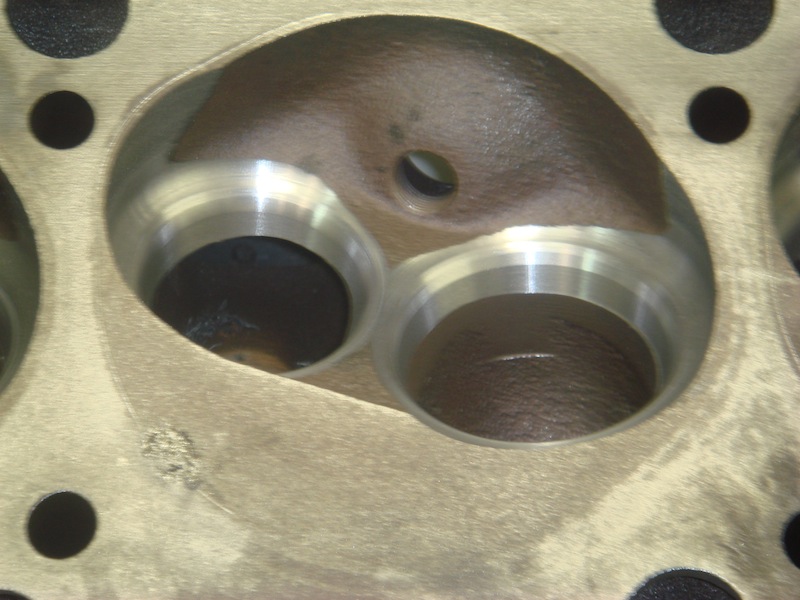

My goal was to build a smooth idle 9.3 compression 467 BBC with peanut port heads (236 castings) then put it in my 1968 Chevelle for a drag test, yes a real drag test. Some pictures as the build went along. The center piece of my build, notice the symbol.........that sure isn't a hump there!

Any pics of the finished intake ports?
Just curious--have you ever tried working a set of "820" heads? They have a relief cast in the chamber by the exhaust valve similar to yours
(pic snagged from the internet)

Yes, I have used them, Its actually a similiar chamber as a 215 or 063 or 290 with that cut out behind the valve.

Those look like the '69 '148' chambers.
Does anyone know the chamber size of stock '148' heads? I've seen a lot of conflicting info.
