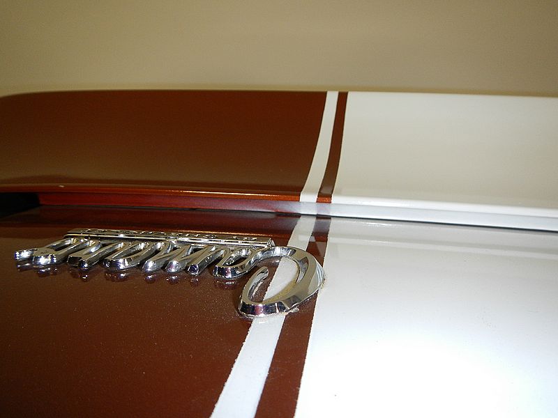

Mark M's Los Angeles Z28 has it as does the 1100 mile survivor. Mark's Z is the first photo, the 1100 mile car the second. Note the difference in the stripe application cut off near the window trim on a LA vs Norwood Camaro.

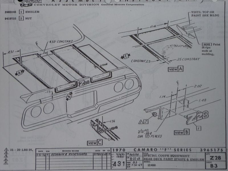

Here's the page from the assembly manual
