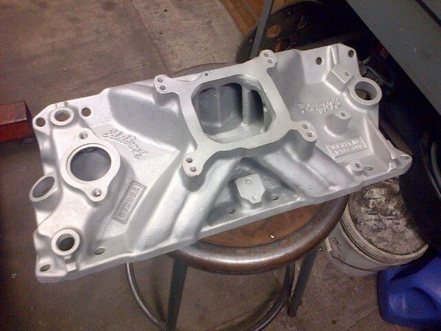

Ok guys, we at KMST-Detroit Muscle (Mascar) are going to post often to share with you the build we are doing on the FB Deuce, we are pulling the #s drivetrain and will be replacing it with a Borg Warner T 10 and a 1970 350 4 Bolt service block with a vintage intake, carb, headers, wheels, etc. All parts are pre-1971 and will be built with the parts and technology avaialable in 1971. We are treating this as if we are back in 1971 and we blew the motor and wanted to build a street fighter with the best available parts at the time.

Don't wanna bust your chops but that intake is around 1977-1978..Scorpion intake with nitrous ports.

Earlier style Torker with open fill hole up front pointing to the passenger side...later (mid 70's) Edelbrock changed the oil fill hole to point the opposite direction for the newer GM cars..that is one way you can tell the difference.
The SBC TM-1 is the most accurate for 1971 but I don't have a pic of one of those.
