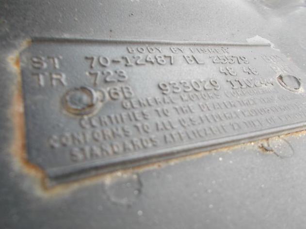

does all 2 gen z28 Camaros have z28 stamp in the cowl tag from 1970 1/2 threw 1973 thank you

LA cars did not only Norwood for 70 not sure on 71,72 or 73

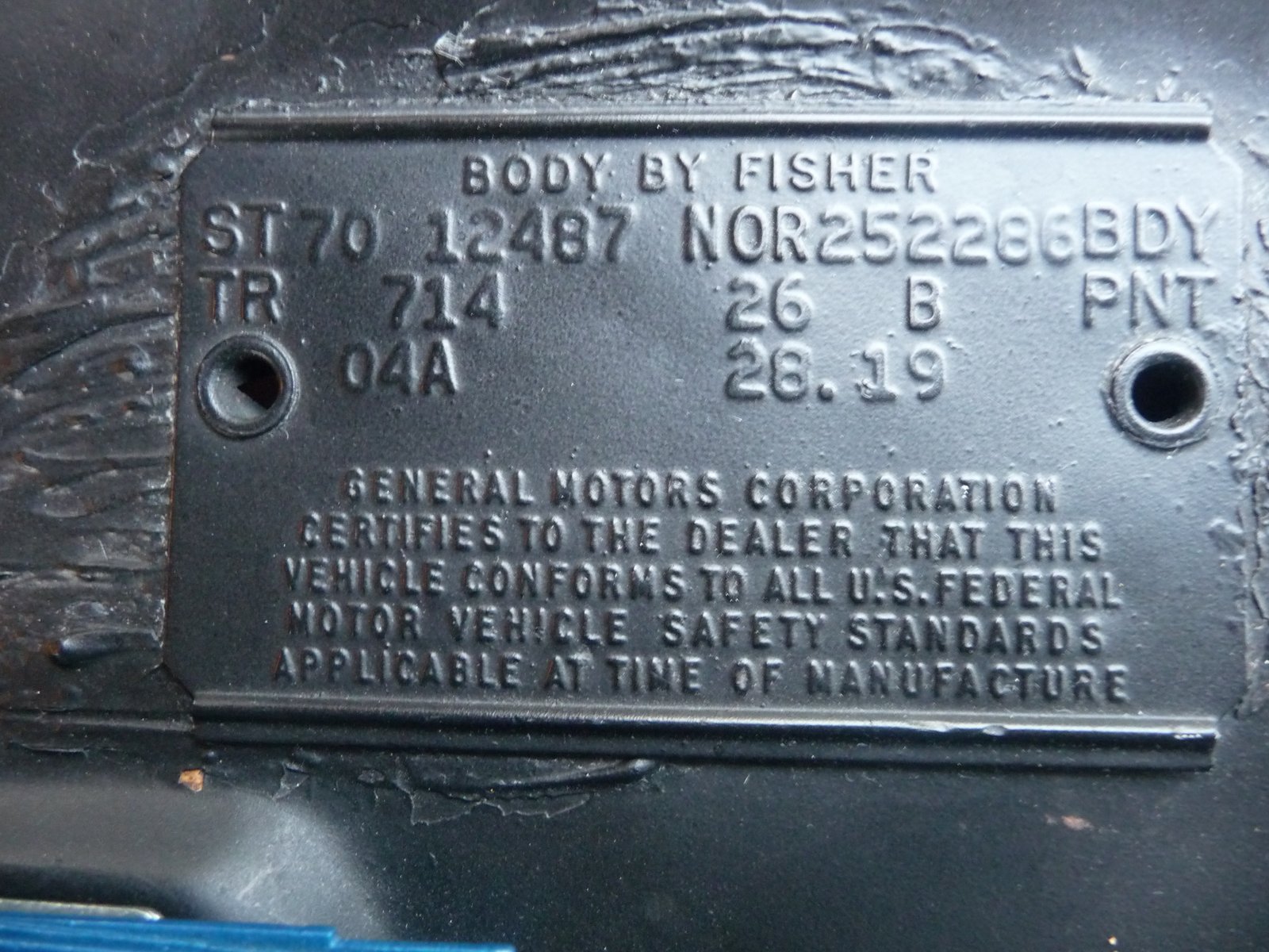

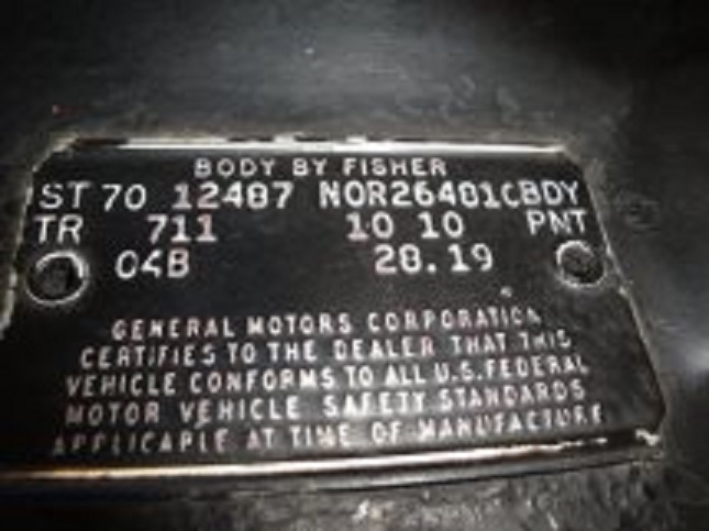

Also for a number of weeks in spring 1970, on Norwood produced cars the "Z" stamp wasn't used and the TT was stamped "28.10" (Z-28 with white stripes) or "28.19" (Z-28 with black stripes).

Couple of examples.
