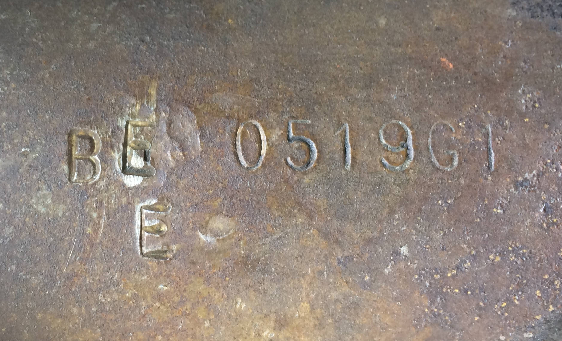

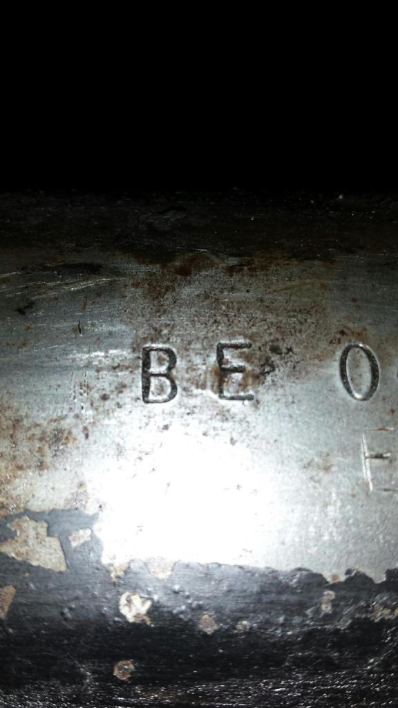

1969 Camaro 12 bolt BE posi. BE code heavy duty, casting date E-5-9. On rt. axle tube BE 0519g1. Rare copo 12 bolt posi. Make offer.

BEWARE !!!!!! a guy in the same area code by the name of Frank K got me on a restamped BE!

Would be nice to see the stamp, looks like a good date, I have 2 0519 G2.

Just to clarify my last post...I have pictures of 2, not the actual BE, sorry for any confusion.

The guy has this axle in several craiglist ads all over the country.
I saw pics. Date looks OK, but the E in BE looks modified....
Kurt S - CRG

By popular demand....
