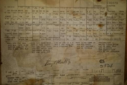

I'm looking for some help on a buildsheet from a 1970 SS Chevelle. I'm no expert in this area and it looks legitimate to me, but I'd like some opinions.
Sorry the pics aren't the best.

Hard to tell without a closer view but probably legit. Interesting color combo, Autumn Gold with a White painted top. I used to own a 70 396 car that was Champaign Gold with a White painted top, Saddle interior and Black stripes. Maybe someone will chime in that can enlarge the pictures but more than likely real. JMO

Yes it is legit.
Car was not ordered with a Posi rear, No power steering, No Stripes or Cowl Induction. Antique Medium Saddle Coated Fabric Bench seat with Auto on the Column as pictured.
Very Different combo though from the rest as there were not to many 2 tone SS cars ordered.
Very limited options outside the mandatory SS Stuff, Tinted Windows, AM Radio, Rear Speaker, 2 Tone Paint and Vinyl coated seats.
I can picture a made to order SS car for a family cruiser ordered by the dealer as this is not an XXX Customer ordered car. [img]<<GRAEMLIN_URL>>/biggthumpup.gif[/img]

Thanks for the help.
