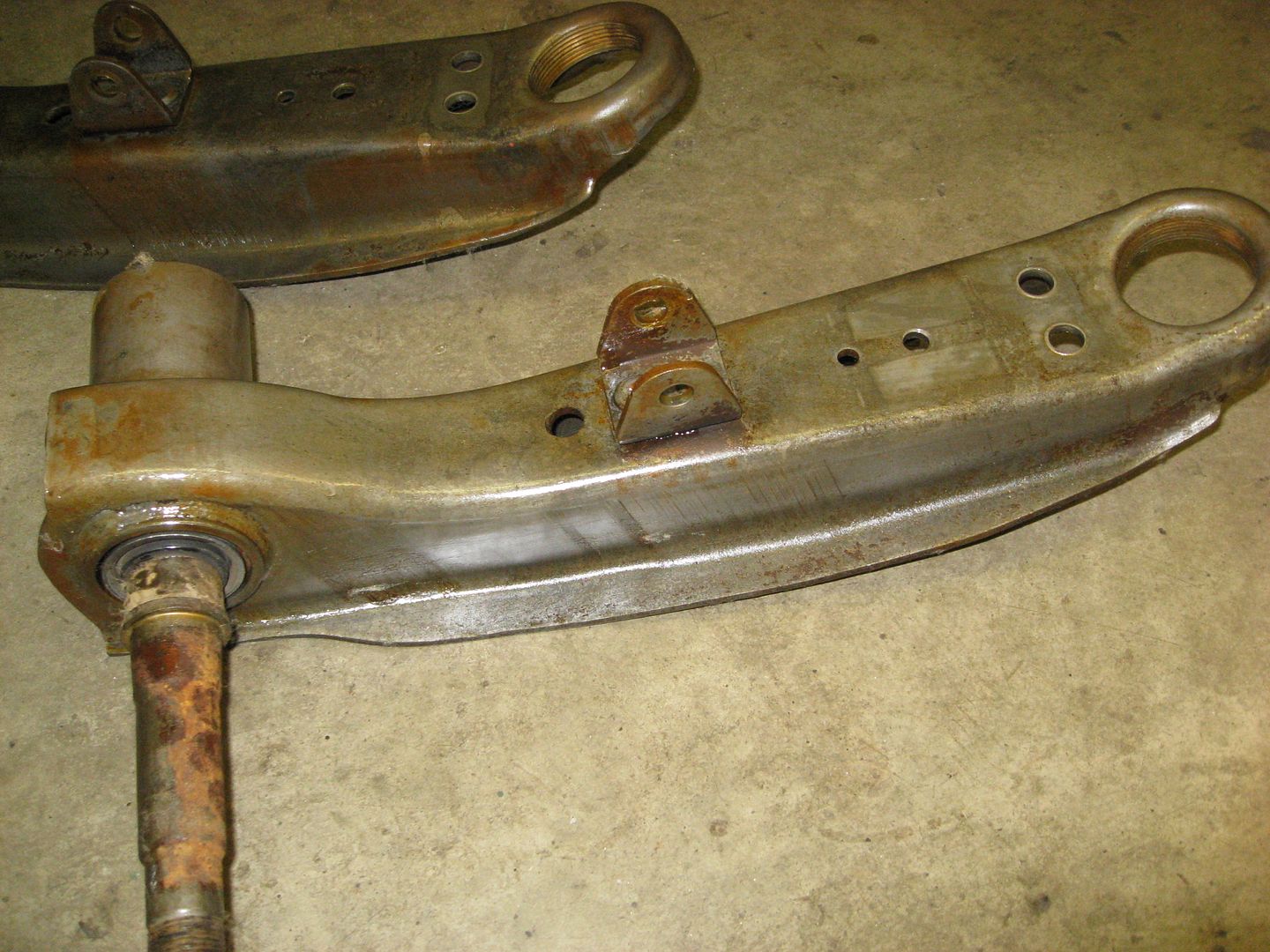

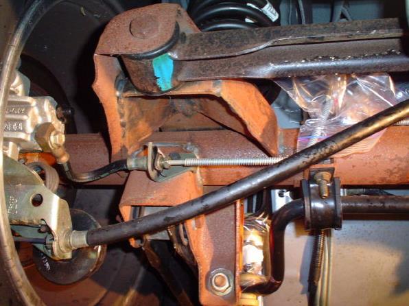

I've seen the results and I'm impressed. And a little confused.
I think they are pretty similar. Is there a preference for one product over the other?

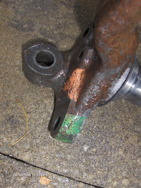

I have only used Evaporust. I have found a lot of paint markings that I would have never found. End of my axles were dingy so I set them in the bucket over night and this appeared.
