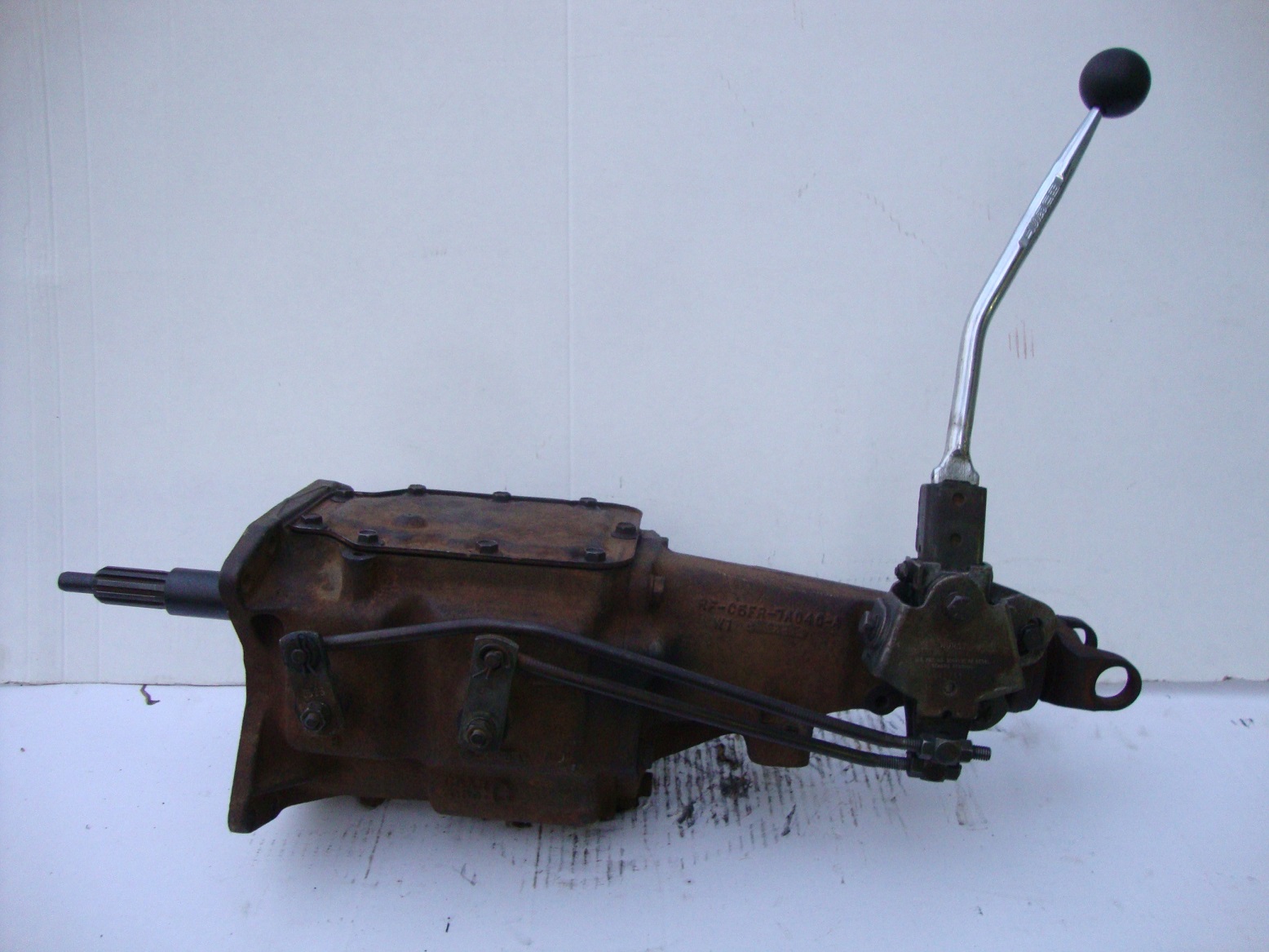

The GTO 3 speed manual transmission was based on a Toploader Ford unit. Here is one I recently had.

Pontiac had to buy 3-Speeds from Ford because GM hadn't any that could handle the torque.

I realize the early BOP cars used the Ford top loader 3 spd, but did they not use the HD Muncie 3 spd in 1969 like the Chevrolet? It is a very heavy and strong full syncro 3 spd that was introduced in 1968 as the M-13 and I believe that it had a 2.41 low gear ratio.

In 1969 the GTO used the toploader.
