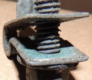

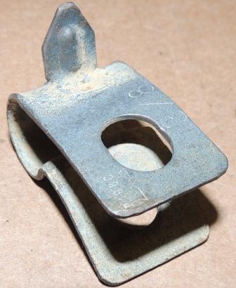

Neither of the above kits match up with what is on my car. I have all original brake lines.
Hard to find much paint on my originals. Have attached four pics. Two are a 3/8 (with locator pin) that I swear has remnants of pink paint on it. It isn't phosphate. It is paint. I haven't seen any info on pink clips. Other two are a 5/16 (with locator pin) with a dark aqua/green paint. Have 3/16 with locator pins that had remnants of black paint.
So.. for those three styles, I am mixing up some testor's paint (except fot he black) to match as best I can.
In addition, I have some 3/8 clips without the locator pins; I cannot find any color on them. Anyone know what color those clips are?
If I am way off on the others, someone let me know.
