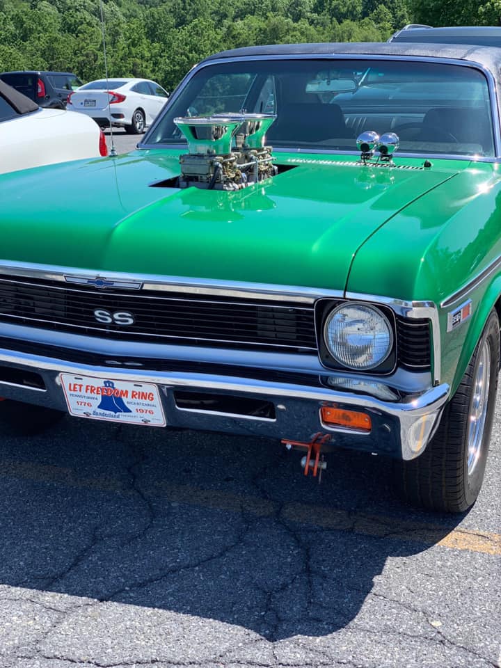

Does anyone know the time frame on the two pictured?
Don't worry about Stunkards picture of the Camaro. He won't mind.

1974 ish...
