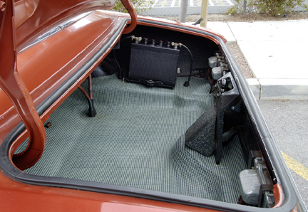

Any Day2 suggestions for a trunk mounted battery? were there any preferred vendors in late 60s early 70s? thanks guys, adam

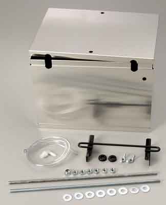

i found a few different versions. thoughts?
Old 10-27-2011, 09:50 PM
whitetop whitetop is offline
Location: Ohio
Posts: 2,201
Thanks: 17
Default Re: Trunk mounted battery
Middle one looks most era correct-maybe try to tone down the shine, get rid of the clear plastic hoses and uses black rubber instead.. Last one looks to billetly/modern with it's cast and polished brace. First one looks kinda amaturish but that is the look many are after with all out race cars.

thanks for thoughts. i think the first version was used in the mid 60s hemi cars. the second is aluminum. the third is polished but its availble without that shiny finish. i love this stuff

My Day 2 project 69 camaro has a rear mounted battery on the right side. It was in a old Moroso plastic box. You have to be careful how you wire a rear mounted battery, so you don't have continous live wires running through the car. If you get me your phone number I can help you out or draw you a wiring diagram how we did it. I love the way it looks!!! Even the disconnect switch looks good!!!
