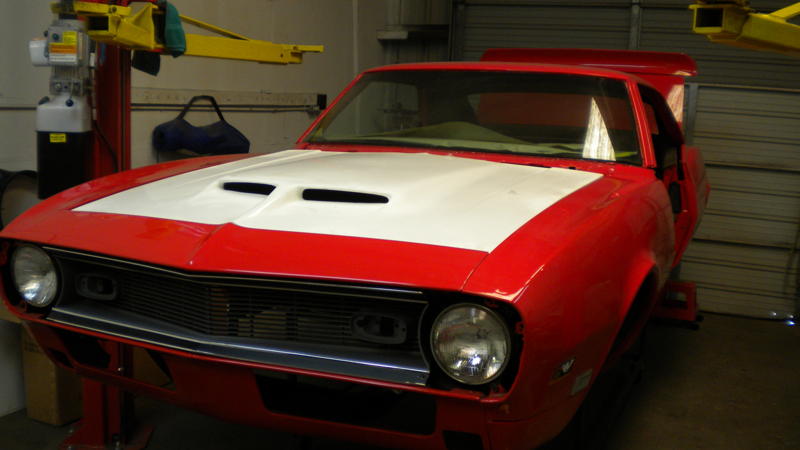

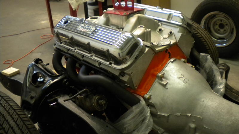

Hi Guys and galls,
I am new in this site and need some help as to what is an acceptable mod and what is a no-no for a Yenco. I am restoring a 68 comaro and so far have the correct snorkel hood, a 427 with patriot heads, a t400, and 12 bolt rear with 4 leaf springs and 4 wheel discs. I am looking for a genuine block and heads to go with a powerglide to put in at a later stage.
I have the gauge console,tictoc tack and 140 speedo and intend to paint it matador red.
my question is what is acceptable ?? headders, brakes,ect and what is not like paint, trans, hood, decals, wheels.
Cheers: auschris

This is the feedback I need to hear as it sounds like I am getting the wrong info, its more me being a dumbass when it comes to these cars so here goes with a couple more questions.
Q, Was a powerglide with a manual valve body an option in a 68 SS or rs ?? (i think they called it a torque drive)
Q is a T400 acceptable as I think they came in 69 not 68
Q is it better to go long or short water pump as I believe these were 427 corvette engines.
Q what was the difference between the L88 and the L72, my thought was the L88 was a 4 bolt with 7/16 rods, 11.1 forged pistons and closed chamber rectangular port aluminum heads.
Cheers: Chris

T400 was only an option in 1969, as far as I know. 4-speeds only in 1968.
An L72 has iron heads.
From 1965-1968, BB Chevy engines used the 'short leg' water pump on all passenger cars & the Corvette. Should be pump # 3856284. In 1969, L72 engines on passenger cars had a different pump than the Corvette.

So if the L72 had iron heads were they still closed chamber rectangle port (where did the aluminum head fit in the picture). and did they have a solid or hydraulic cam ??
someone also said they had a 780 vacuum holley.
and was the L72 a 4 bolt steel crank deal???
