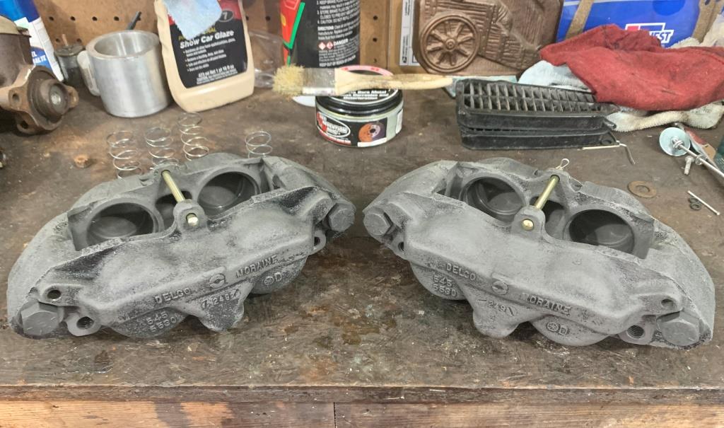

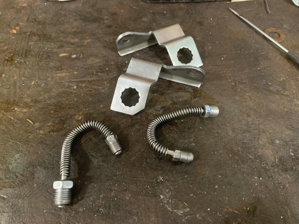

Photos 281 - 282 - Original calipers before teardown and cleaning. Cleaning was like many of my previous cleanings. Citrus degreaser then soaking in Evaporust. Then coat with RPM or Rust Veto or alike. Currently I am using up my RPM as it seems to work very well.
Photo 283 - Results of bracket line brackets and lines after cleaning. These are original finishes. Nothing was rezinc'd or refinished.
Photos 284 - 286 - Calipers after cleaning. I did have to buy new pad pins as the originals were MIA as noted in previous photo as someone had installed a nail in place of one of them in the cars past. I will have to send these out as 2 of the 8 bores are pitted so stainless sleeves will be needed. Note black paint still present on the rears of the calipers.

Who are you using to sleeve the calipers?
  #98
Old 05-24-2022, 09:37 PM
cook_dw's Avatar
cook_dw cook_dw is offline
Join Date: Oct 2003
Posts: 4,388
Thanks: 672
Thanked 1,725 Times in 660 Posts
Haven’t decided. White Post Restorations currently has the master cylinder (they received it on 5/6) and I’m waiting for it to come back. Depending on turn around I’ll probably use them but it’s $320 per caliper (4 piston) plus shipping. I’ve used them in the past with good results so I have no experience with any other company. Maybe someone else can chime in on their experiences with someone else?

Amazing those brake line brackets came out so mint.

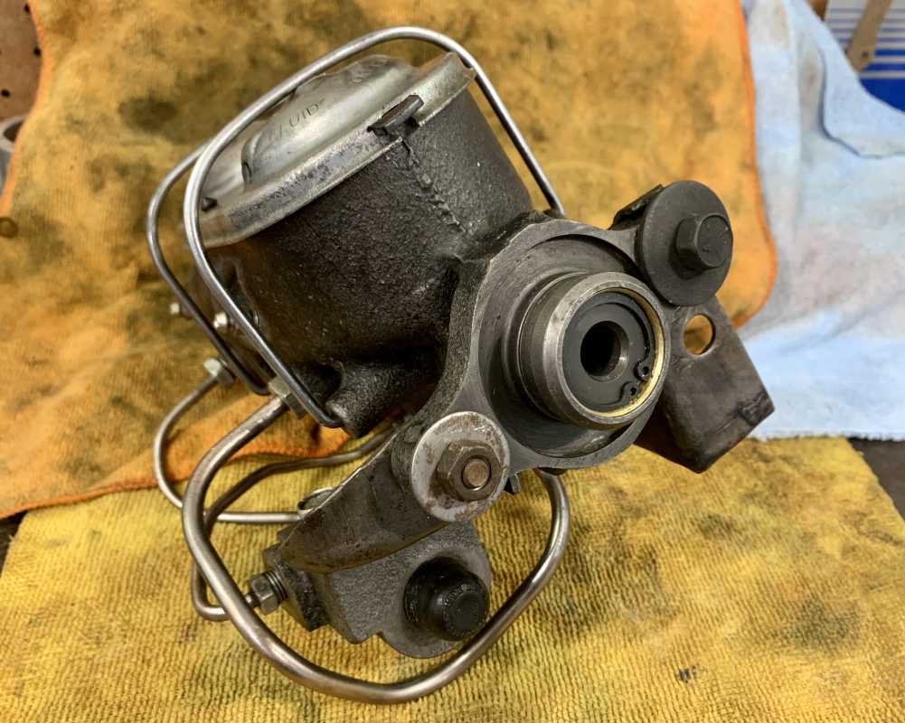

Photo 287 - 289 - Finally got the master back from White Post and I assembled the components.

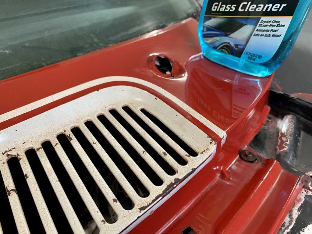

Next I decided to bounce back and clean up the cowl panel & wiper transmission.

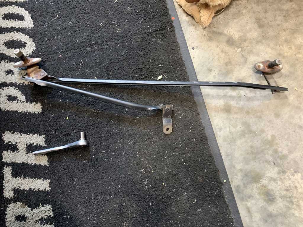

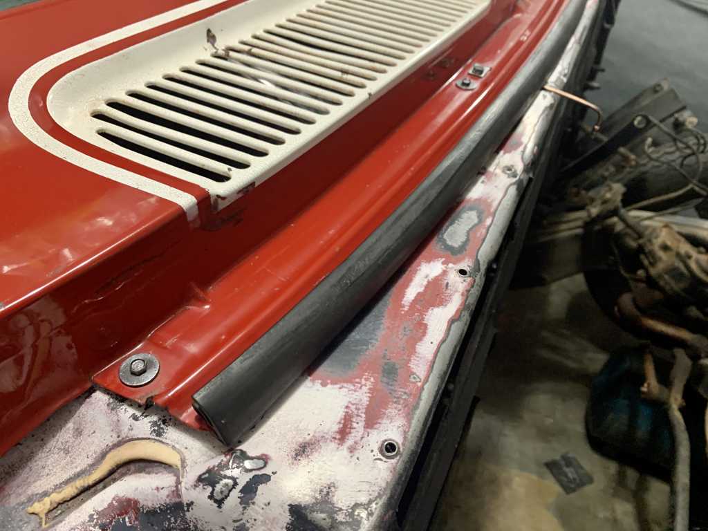

Photo 290 - 291 - Panel & linkage before cleaning.

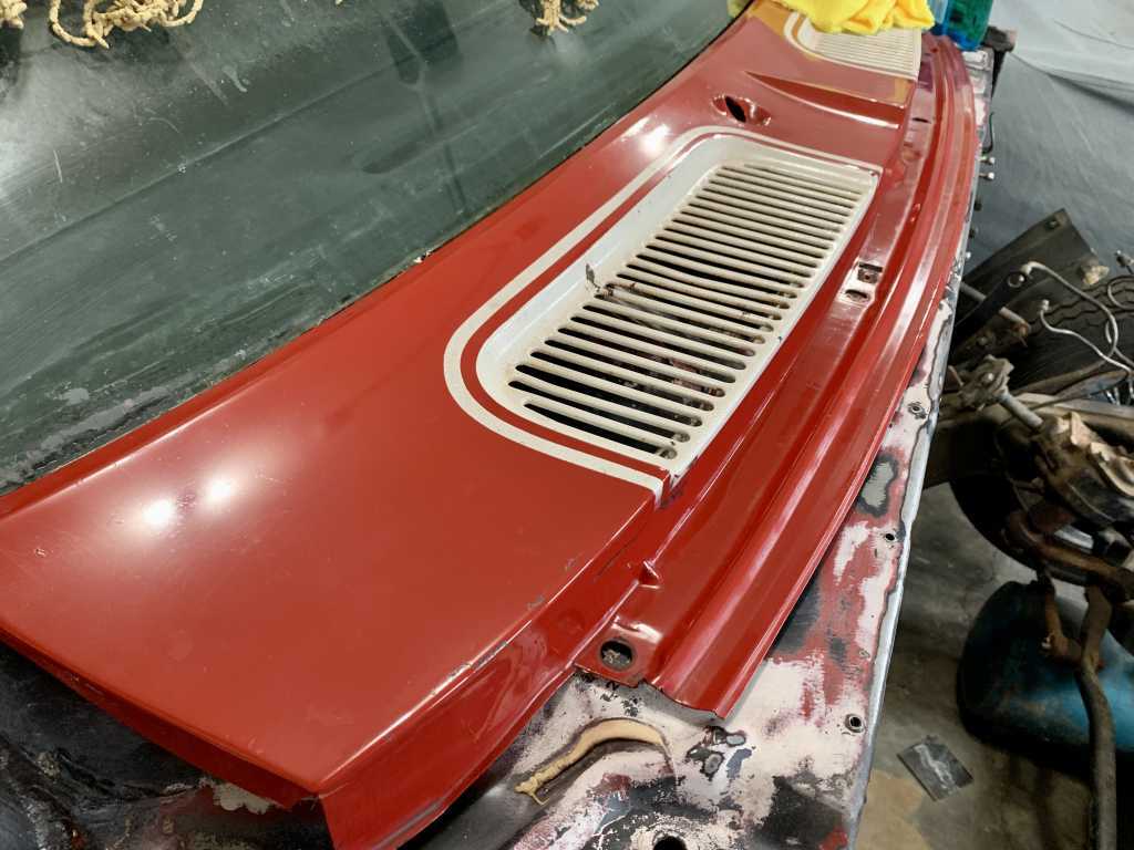

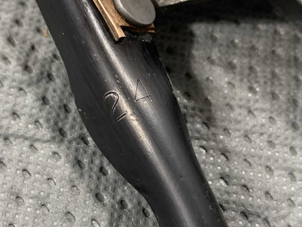

Photo 292 - 295 - After cleaning, Meguiars #7, wet sanding with 2K, Meguiars 105 & 205, and Meguiars #7 again.
Photo 296 - 298 - screws, squirters and cowl seal added after they were cleaned.
Photo 299 - 302 - Lastly are details on the wiper transmission linkage after cleaning.
