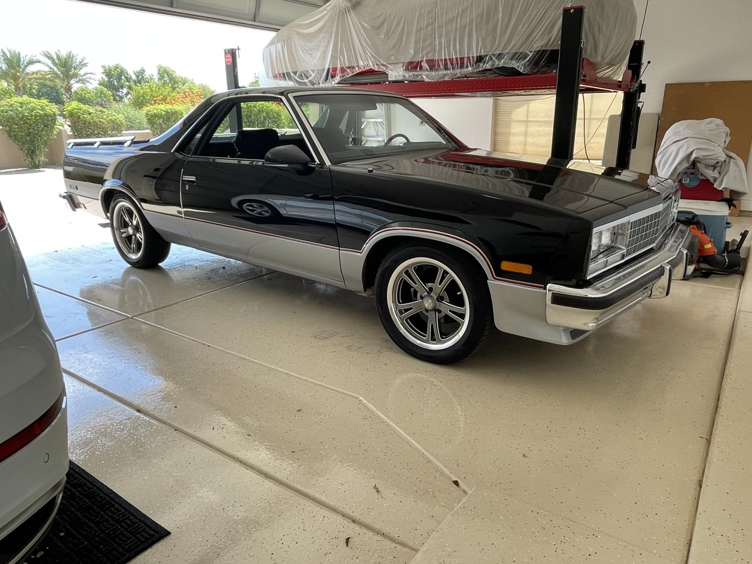

----Wow, that's a great looking El Camino! Makes me wish I had never sold my 86 as I really liked it. Proir owner to me kindly installed a ZZ3 in it, so it delt with the one thing I have never much cared for, lack of power.

thank you...i looked for a yr before buying these wheels - and moved up from the 14 inch stock wheels to these 17 inch. I worried it would be too big a wheel, but not.
