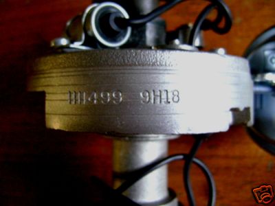

Is this a re-stamp 1111499?
The latest dated 1111499 that I have found was dated 9D28.
I have seen 1112000 distributors with 9GXX dates, which are still in original owners cars.
Wasn’t the 1111499 replaced by the 1112000 in early July of 69?
PM if you don’t want to make a public post.
Thanks in advance.
Eric
Attachments - The Supercar Registry 352633-tn_499dist1.jpg 352629-tn_e50d_1.jpg 352626-1111499-9H18.jpg

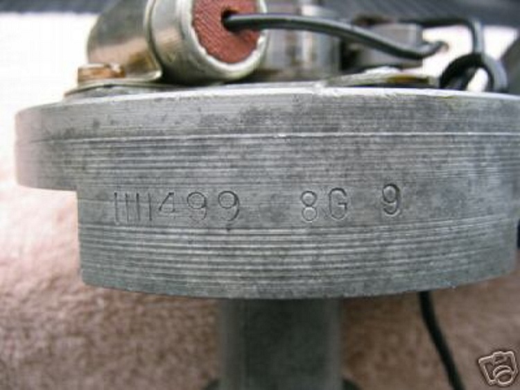

pic

real 499

Thanks for the reply and pictures Alan.
I thought it was a restamp.
I checked my 499 last night and the "9"s had two different fonts like the one you pictured.
Eric
