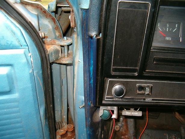

I'm about to send my 1972 Nova out to be painted and have to choose what color I want the car to be. Before, I had my heart set on red, but now I'm really starting to like black. Did novas ever come with a red interior? If the car was black with the red interior, no chrome, and redlines with dog dish hub caps, it would look incredibly tough. The only way I will paint it black is if I could get a red interior for it. So what were the interior color options for novas?

69 was the only year you could get a red Deluxe interior. All of the 69 stuff will fit your interior as long as you don't have the high back buckets. If you have a bench, you're as good as golden. The only thing that may be different are the A pillar mouldings. In 69, they were padded, and 70-72, they were metal. But you could also paint them any color you wanted. But, yeah that would be a sweet ride!

Sounds good..But what about the dash pad and all of that? Would there be a fitment issue trying to put the 1968 pad in the 72'?

A 68 pad is all by itself, but unless you are a stickler for grain texture a 69 will work in a 72..BKH
In the Nova, the dash pad grain is the same from 69-72. In 73-74, it changed to a different texture. However, they are directly interchangeable.

Don't think that the 68 pad will fit a 72...?

A 68 pad is smaller than all the rest..BKH
