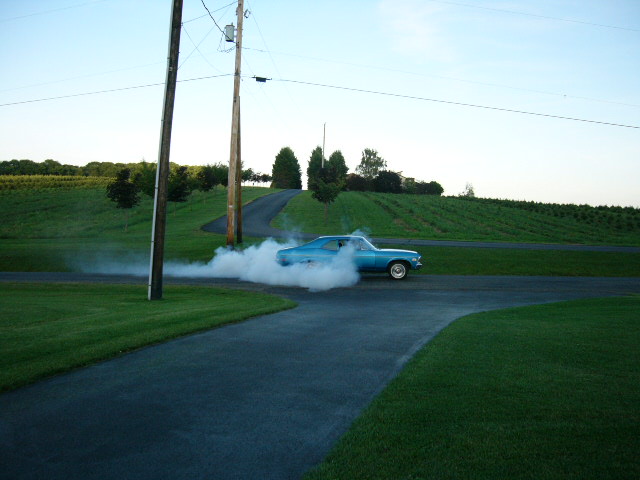

I just picked up a 1 owner 72 ralley nova and it has bucket seats console and 3spd auto floor shift with rubber floor mat..I thought bucket seats would have been the dlx interior therefore u get carpet?

has nothing bare bones....but man it will do a awesome burnout!!!
