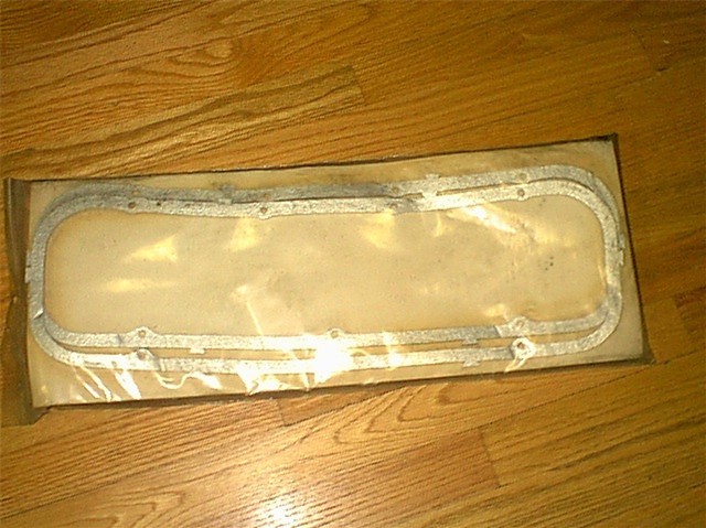

pic

Default Re: Big Block oval port intake gasket ?
pics2
