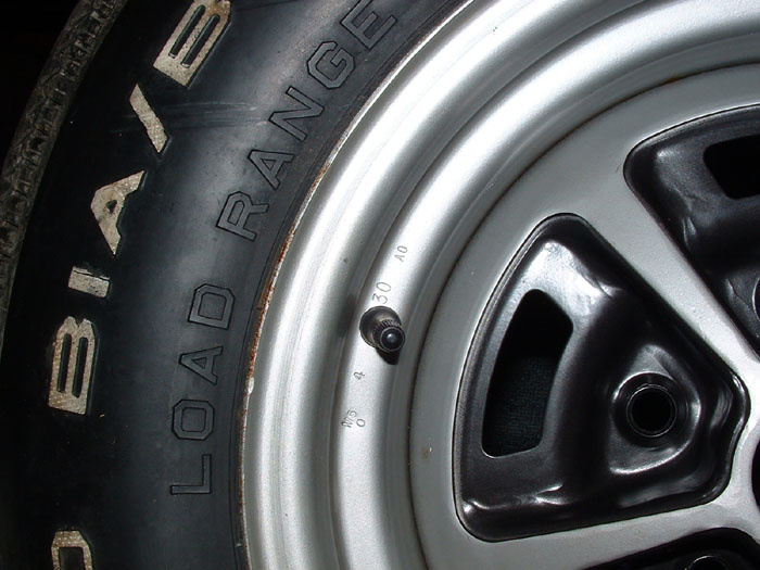

Wilma and I were kicking this around today, by general consensus, what is the correct shade, and degree of gloss, of the black/gray center sections of 70 5 spoke SS wheels.? Who makes the best paint to restore these.? Thanks SULLY

The wheels are going on my 70 L78 Nova, I have a coat of the Details/Ground up spray bomb stuff on them now,I think it is way too glossy though. I would like to see what an untouched orig wheel looks like. What paint is everybody using.? Thanks SULLY

PPG DP90LF mixed as a sealer, shows up about 60% gloss black. I'm one of the few I guess that feel that the deuce wheels should be black - but I know of some NOS wheels found at Yenko Chevrolet are Charcoal, so

Good pic there Joe/Eric The color of the wheel inserts has been the topic of much debate over the years within the Yenko Deuce community, with no real conclusions yet - except that both black and charcoal have been found.
The set of NOS Magnums pulled from Yenko's shop are still in the Motorwheel boxes with yenko labels on them, and they are reportedly charcoal. Several cars have been found with black, others with charcoal, so it's still a tossup.
I painted mine black bec/ that is what I found on them, and they were original condition. I think the Wargo car has black, but I think Tommy K found charcoal on his original condition a/t deuce. So, it appears that both colors are applicable.
