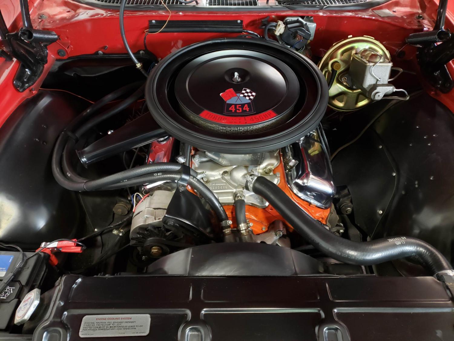

If anyone cares, here's an ugly '70 Chevelle supposed L78 car. . It looks like it's probably true but w/ 12 bolt, F41 and 6500 tach wonder if possibly an LS6 could be hiding behind those fancy bumpers? . Here's the link but somehow it's not highlighting the whole link? ~ Pete

Wow, calling this Chevelle ugly is an insult to ugly Chevelles. What were they thinking when they painted that engine compartment.
I may have to bid on it.

1970 L-78 equipped Chevelles were only assembled in the first 100 days of production at ALL 6 assembly plants.They were phased out for the new LS-6 engine after late November 1969.Michigans Flint plant only built Chevelles in September 1969,and then stopped from Oct.1st 1969 to Jan.31st 1970, before starting up again in February 1970.This car was assembled April 1970,2nd week so if it's what he says it is and the tach is authentic to this vehicle,it would have had to have been an LS-6 originally...Unless he or anyone else can provide past history to suggest otherwise.
The rearend code could be a clue to true it's heritage,among other items.
Interesting that it's a Flint build.

Great info Rick....sure looks like it's worth looking deeper at this being an LS6! . If true and although an ugly duckling now, considering that beaten one that went for twenty'ish last week, the BIN would be a great grab? . Sure wish I could afford it right now....have fun fellas'! ~ Pete
