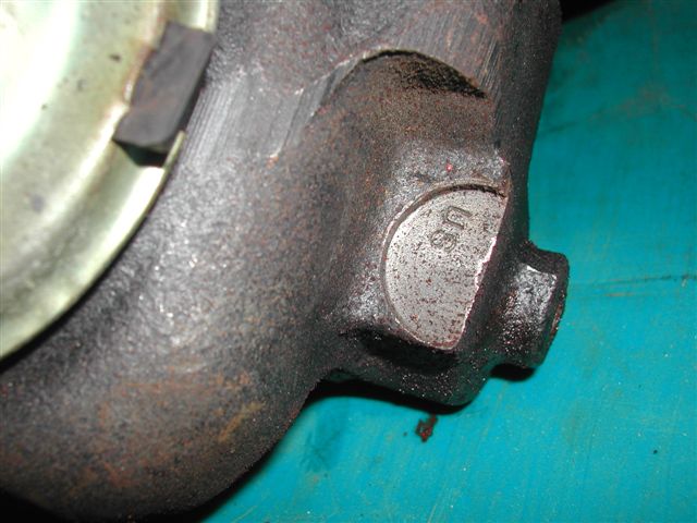

Car is a September '69 Build date... Everyone I have talked to has told me those a.i.r. tubes are correct for a late car. According to Jerry M's book they are different from the early car too. I have spoken to Jerry about them and he thinks original (if my memory serves correct). ATL has been rebuilt and restored, part number is correct though. This is not the first time I have heard the master is wrong. Matter of fact we have a slight brake problem with the car. Can anyone provide a picture of a correct unit? What is the part #? I would like to check while the car is still in storage.

The shape of the master cyl. gave it away it is square and the correct one Darren posted is round the part # is 309 and the stamp on the pad is US I will post a picture of the stamp in a few mins.
It's a great looking original car
Heres the pic...
