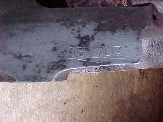

I have a DZ block that I wnat to verify that it is real. The casting # is 3956618, the build dat is B 13 9 and on the front pad is VO3I7DZ. I can not find a VIN # any where on the block, I have looked by the oil filter but it is't there. I seriously doubt that it is a restamp, I have had this block for over 22 years. I know that if anyone can help it is you guys. Thanks in advance. Bob

The 3956618 casting number is correct for a 69 302 engine, used for a variety of vehicles, 2 and 4 bolt, including the Z.
Casting date - Feb. 13, 1969
Datecode - March 17th, 1969 DZ - 69 Z28, 290hp, 4bolt with 4speed Muncie.
It is sometimes a real pain in the A$$ to find that Vin# down by the oil filter. Try using some silly putty.

Can you post a pic of the DZ stamp

A real DZ has a vin,they ALL do, sometimes you really gotta look for it, try a half covered 400 watt light bulb by the oil filter. Restamping was going on 22 years ago, just not as rampant as it is today...

Here is a picture of the block stamp

Find the VIN on that block and your in business

I'll bet the VIN is stamped by the filter. I have one that you couldn't see at all until I had it hot tanked.
