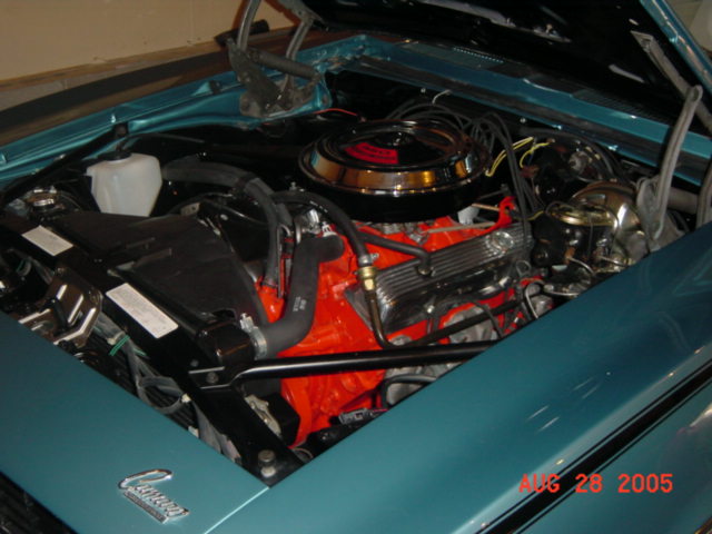

Here is a photo of a correct installation on a 69. They seem to face out, not necessarily forward or backward

The terminal on the horn that the wiring hooks up to faces the rear and the horns face forward like in the pic. If you flip floped them around the other way the wiring on one side would jhave to go over the top of the horn to connect up. Above pic is the correct way.

Jonesy, I've had them facing FORWARD and facing REARWARD...and either way works without doing anything wierd with the wiring.....The above attached picture is too dark and not conclusive.......
I will forward this to Shaugger, Henderson, and others for more opinions...was hoping to HEAR or SEE what assy manual SHOWS!!!!
