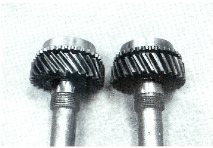

Good saved me diggin that spline info out----Here's a better photo --M22 on the right--on left --M20/M21---- The no groove cluster gears are as follows--2rings=M20,1ring=M21, no rings = M22, 1963-1965 M20 or replacement part---(can't gone wrong lookin at the gear angle)
