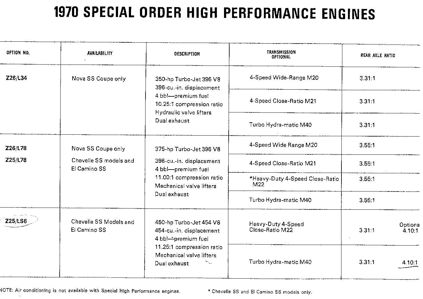

How would i find out what the rear axel ratio that would have come from the factory on my new toy(70 chevelle SS) the window sticker just says Option G80 Positraction Axle.
Is there a good reference site for this ?
heres the option list :

Being an M22 car I'm gonna guess 4.10s...

Was 3.55 the standard ratio on an SS454 manual transmission car? If so, then I would say the 3.55's would be correct for a car where no "performance" or "economy" ratio was stipulated on the new car order form. Posi was an option on virtually any ratio.
If I recall, I'm sure I have seen LS-6's, let alone LS-5's, advertised with M22's and 3.31 rear end. All in the hands of the person putting in the order.

My 70 SS LS-5 car...M-22..3.31 posi. Only two rear ratios for 70..3.31 Axle code CRV and 4.10.

In '70 I think most of the M-22 cars got the 3.31 unless the optional 4.10 was ordered. My LS-6 conv. had the M-22 & the CRV 3.31 rear.

Yes, there is a good online site for your question. Check your rear axle code on the tube and then check this site:
http://www.chevellestuff.com/index.htm
Go to generic info, then click on axle codes/ratios. You will need to crawl under your car on the passenger side and look for the code on the front side of the axle tube. Then compare it to the code on the link above. My LS5 car with M22 has the CRV code which is 3:31.
