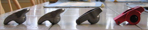

maybe this will clear it up. I have 2 RAIV's always used the RAIV gaskets and never noticed they were any different.

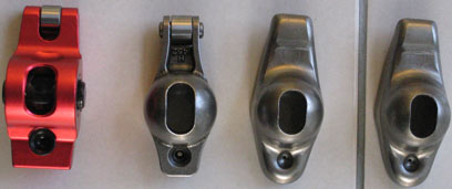

heres another one
The rocker on far left is full roller rocker, then a roller tip rocker , then a 1.65 rocker , then a 1.5 rocker.
Can you see any size difference between the 1.5 and the 1.65??
You could be right, but I never measured the difference in gaskets, but The rockers never hit the valve covers either way. As you can see the 1.5 and the 1.65's are identical in size.

The rockers look the same but the ratio / geometry is different, the IV's also used longer pushrod and a special anti-pump up lifter. Having owned both a 455HO and a RA IV car not many engines have a better sound at idle, except for maybe a solid lift 427 Chevy
