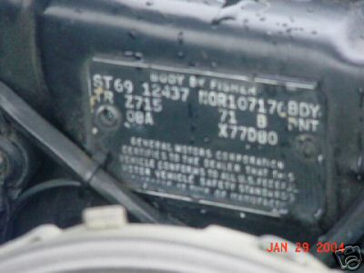

Trim tag has Z715 for interior option. Have not seen this before. Can anyone explain this? http://cgi.ebay.com/ebaymotors/ws/eB...tem=2457332086

First time I have seen a tag like that.

Probably just a typo for a 715 Dark blue Standard Interior car.

Yes, I would go along with that, it is probably a typo.
