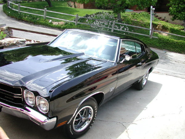

No that would not be me. I am Myles. Thanks for the welcome! Here is a picture not that clear but you can get the idea. Not a Super Car but it's baby brother with a 396.

It's a SuperCar in my Eyes.

Hmmm. Looks somewhat familiar. Nice!

I am not sure where you have seen it in the past. The car was in Virginia for a while. Even though it looks like the one on Ebay #2452626127 it is not. Don't make me prove it!
