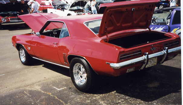

I'm in the process of restoring my 69 BM Camaro and wanted to solicit some opinions on tires. For wheels I will be using Crager SS.

I thought I would bump this post back up to get a few more opinions. I will be running 15x8 Cragers SS on the rear and 15x6 up front. My understanding is the largest rear tire that will fit in the wheel wells is equivalent to a 235x60Rx15. The car will be Daytona Yellow with black striping and mid-year corvette side exhaust. I was planning to make a run up to Chattanooga in the next few days to pick up the tires from Coker Tire so I need to make a decision soon. Thanks

I have put 255 60 R15 T/As on Z28/Yenko 15x7s on the rear of a '69 Camaro with no problem.

I had a 69 Camaro 350 car that I put a set of 15x8 weld drag wheels on with 4.5 back space and was able to run a 275/60/15 BFG drag radial. I can send you a pic if you like.

Backspacing to the max ( ie, 1/2" clearance ) has worked best for me. I have only been able to fit about 4 1/2" of back space in. However a custom wheel maker like Stockton Wheel Co. in Stockton Ca. can make a custom set for you with a little more back spacing but they are very expensive.

I would not run the small 235 on the rear-looks dorky. I would run 275-60-15 Pro-Tracs. I know they will fit without any rubbing. I just saw a pic of a '69 that ran 15x8 Cragars and 275-60 M/T's and the car was not raised. As a bonus the Pro-tracs are just slightly less in width than the m/t/s and actually came out before the M/T's in '70 so they are more correct for your application anyway. L-60-15 (275-60) M/T's were introduced in March '71. Pro Tracs came out in mid to late '70' based on the ads I've seen.
I think with rims/tires if not sure what to run always go bigger to be safe. A bigger tire looks less dorky than e smaller tire.
I'll post the pic tomorrow. You will agree the 275 looks best once you see it.
