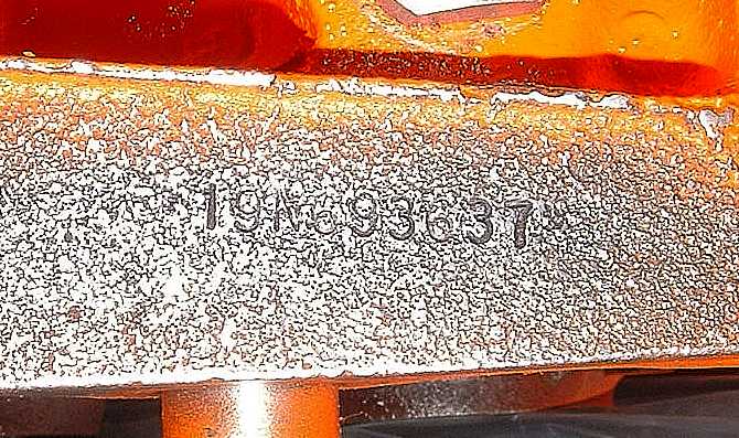

You talking about the orange and black convertible? Nice looking car but:
ZL2 hood is not original, stripes are incorrect, only Z28's Z10's and Z11's had Rally stripes. Stripes are painted as if they were dealer added since the rear lip of the trunk lid has the stripe on it. Disc brake master cylinder is wrong, can't see if it has a rear proportioning valve, the A/C suitcase is from a Firebird, repro air cleaner, wrong valve covers.
Not to say the options didn't come on the car, just they aren't "correct" now. The engine code appears to be a 69 L48 but it has a typo in it, and the ad says if has the VIN stamp on it. It doesn't say its on the pad but implies it is. It should not have the VIN stamp on the engine pad if it's a mid March Norwood car, and they are almost impossible to see down by the oil filter with the engine in the car. Not enough info in the ad, or pictures to determine if it is or isn't an SS.

Thanks alot. What interested me most from the comments was the part about it not having a partial vin stamp on the front of the block if it is a mid March car. Can you expand on this a little? The numbers from the block "V0902HB" means September, right? I knew the hood was wrong (why would anyone change that beautiful SS hood for a non-functioning cowl?) and the stripes are wrong. I can live with those for now. I really just care that it is a true SS, because they seem to be hard to find 100% correct.
