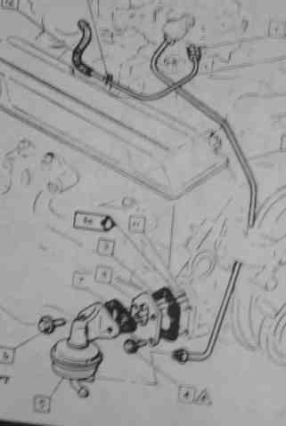

L78Impala;
I just happen to have the AM in my hand and it does not really show. Every other drawing shows the fuel line going behind the water pump. This differences are:
Base - Behind water pump between pass side water pump inlet and timing chain cover near valve cover.
L35 - Directly behind water pump in front of timing chain cover (two lines to the fuel filter, one to carb).
L48 - Not really clear but looks the same as L35 since the water pump is not shown.
L65 - Again not really clear (water pump not shown) center of the block crossing over thermostat.
L78 - No water pump shown, line in center of block on drivers side of water pump bypass
Z28 - No water pump shown, line looks like Base and goes over the side of the block except it is tight to intake and bends around bumps on intake to the tee unlike base. <font color="red">After a second and closer look, it MIGHT be on the outside of the water pump. The part number changed 7-26-68.</font color> What is the build month?
Did this make sense?
Greg
